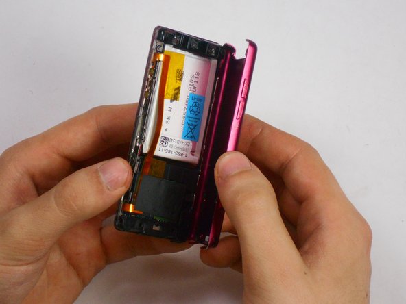

      • Use a plastic opening tool to loosen the bottom portion of device.
    3. Sony NWZ-E473 Battery Replacement: crwdns2935265:03crwdnd2935265:01crwdnd2935265:01crwdne2935265:0
      • Use a plastic opening tool to loosen the top panel of the device.
    4. Sony NWZ-E473 Battery Replacement: crwdns2935265:04crwdnd2935265:01crwdnd2935265:01crwdne2935265:0
      • Use a Phillips #00 screwdriver to remove the two 3 mm screws located on the portion under the top panel of the device.

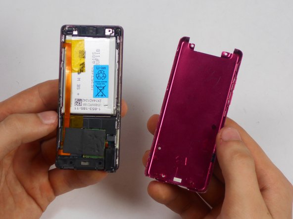

    5. Sony NWZ-E473 Battery Replacement: crwdns2935265:05crwdnd2935265:01crwdnd2935265:03crwdne2935265:0 Sony NWZ-E473 Battery Replacement: crwdns2935265:05crwdnd2935265:02crwdnd2935265:03crwdne2935265:0 Sony NWZ-E473 Battery Replacement: crwdns2935265:05crwdnd2935265:03crwdnd2935265:03crwdne2935265:0
      • Remove the back plate from the device.

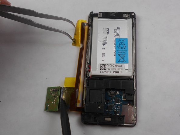

    1. Sony NWZ-E473 Battery Replacement, Battery: crwdns2935265:06crwdnd2935265:01crwdnd2935265:02crwdne2935265:0 Sony NWZ-E473 Battery Replacement, Battery: crwdns2935265:06crwdnd2935265:02crwdnd2935265:02crwdne2935265:0
      • Peel back the layer of tape along with the processor, which is located just below the battery, using the tweezers and the spudger.

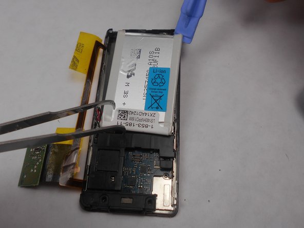

    2. Sony NWZ-E473 Battery Replacement: crwdns2935265:07crwdnd2935265:01crwdnd2935265:02crwdne2935265:0 Sony NWZ-E473 Battery Replacement: crwdns2935265:07crwdnd2935265:02crwdnd2935265:02crwdne2935265:0
      • Slide a prying tool underneath the top portion of the battery and lift it from the case.
