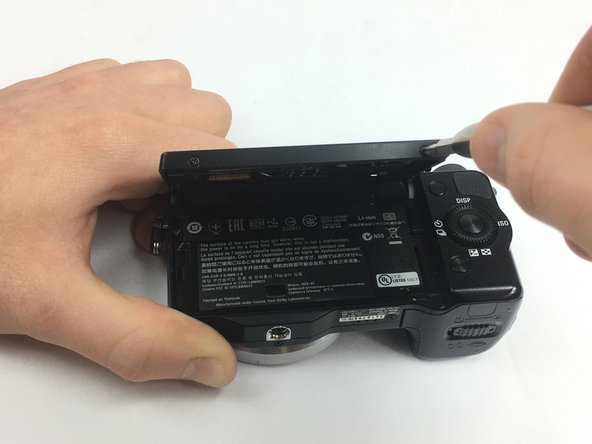

    • Pick up the device with the LCD screen facing you.
    • While gripping with one hand, lift up on the LCD screen to reveal screws underneath
  5. Sony NEX-5T LCD Screen Replacement: crwdns2935265:05crwdnd2935265:01crwdnd2935265:01crwdne2935265:0
    • Unscrew and remove the eight1.2mm Phillips 00 screws.
    • Make sure to apply adequate pressure while unscrewing these screws to avoid stripping them.
    • Removing these screws will loosen the plates which cover the LCD screen.

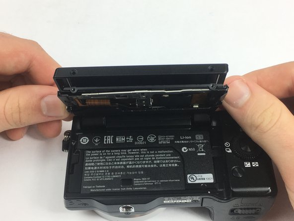

    • Rotate the camera, and lift up on the LCD screen.
    • Be careful you do not pull the LCD too far from the camera because wires are still attached.
    • This will reveal a large black rectangular film which you can peel back with tweezers.

    • You may remove the loose black film from the back of the LCD screen.
    • When purchasing a new LCD screen be mindful that some do not come with the original plastic frame. You may have to separate these pieces by pushing the LCD out of the frame from behind.
    • It takes force to break the adhesive bond, but be mindful to not break the frame when applying force.
    • Upon reassembly place the tape on the inner edges of the LCD frame. When pressed back together there may be excess, use a knife to remove this overlap.
