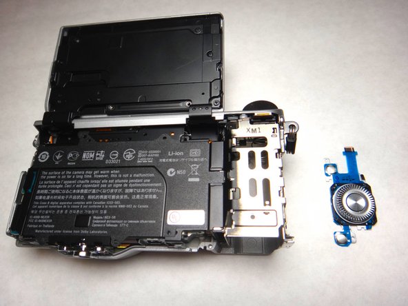

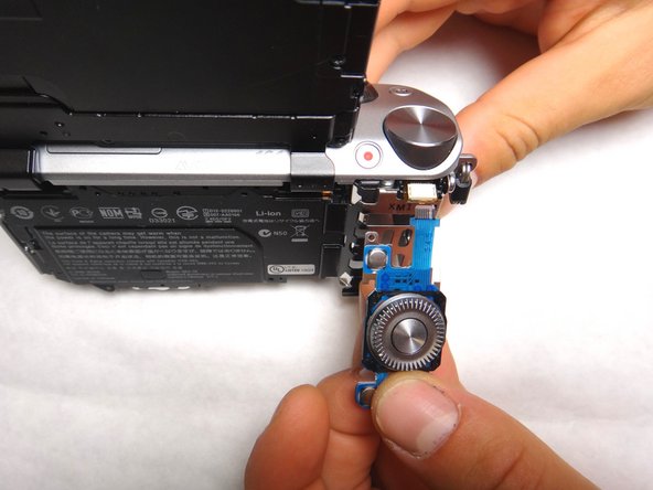

  7. Sony NEX-5R Main Navigation Button Replacement, Main Navigation Button: crwdns2935265:07crwdnd2935265:01crwdnd2935265:01crwdne2935265:0
    • Use spudger to pull the lead out from its housing.
  8. Sony NEX-5R Main Navigation Button Replacement: crwdns2935265:08crwdnd2935265:01crwdnd2935265:02crwdne2935265:0 Sony NEX-5R Main Navigation Button Replacement: crwdns2935265:08crwdnd2935265:02crwdnd2935265:02crwdne2935265:0
    • Squeeze the lead with the tweezers and hold the lead teeth tightly with your fingers. Pull straight out to disconnect.
  9. Sony NEX-5R Main Navigation Button Replacement: crwdns2935265:09crwdnd2935265:01crwdnd2935265:02crwdne2935265:0 Sony NEX-5R Main Navigation Button Replacement: crwdns2935265:09crwdnd2935265:02crwdnd2935265:02crwdne2935265:0
    • The navigation button component should now be separate and able to be replaced with new component. The camera and navigation button should appear as shown.
