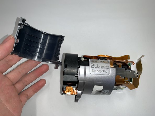

    • Remove the shell of base from the shell of lens

    • The outer casing of the lens consists of two outer casings that are secured by an end cap that connects them. In this part we take this end cap

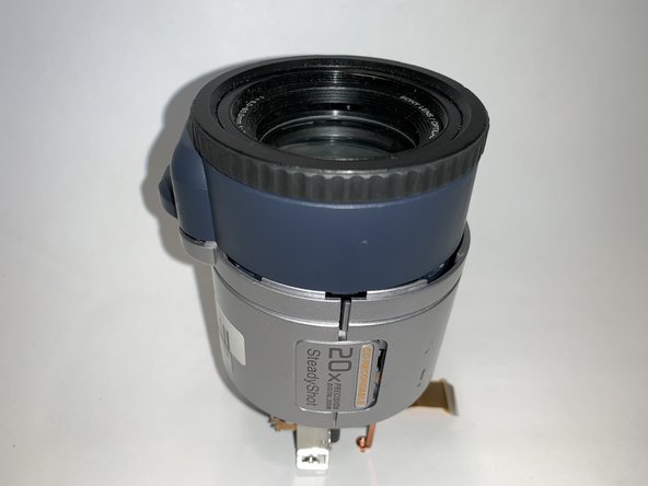

    • There is also a front end cover at the front end of the lens. In this step we take it away.

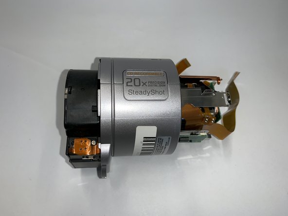

    • Place the lens section horizontally on the workbench and pry open the top cover of the lens with some effort
  5. Sony Mavica MVC-CD1000 lens Replacement: crwdns2935265:05crwdnd2935265:01crwdnd2935265:01crwdne2935265:0
    • After removing the shell of lens we can replace the inside part.
When reassembling your device, follow the instructions in reverse order.
