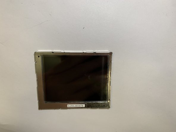

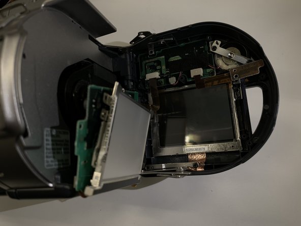

Sony Mavica MVC-CD1000 LCD Screen Replacement
  1. Sony Mavica MVC-CD1000 LCD Screen Replacement, LCD Screen: crwdns2935265:01crwdnd2935265:01crwdnd2935265:02crwdne2935265:0 Sony Mavica MVC-CD1000 LCD Screen Replacement, LCD Screen: crwdns2935265:01crwdnd2935265:02crwdnd2935265:02crwdne2935265:0
    • Gently open this panel using a plastic opening tool or your hands.
  2. Sony Mavica MVC-CD1000 LCD Screen Replacement: crwdns2935265:02crwdnd2935265:01crwdnd2935265:03crwdne2935265:0 Sony Mavica MVC-CD1000 LCD Screen Replacement: crwdns2935265:02crwdnd2935265:02crwdnd2935265:03crwdne2935265:0 Sony Mavica MVC-CD1000 LCD Screen Replacement: crwdns2935265:02crwdnd2935265:03crwdnd2935265:03crwdne2935265:0
    • Use the suction cup to remove the cover and pull it out of the device.
  3. Sony Mavica MVC-CD1000 LCD Screen Replacement: crwdns2935265:03crwdnd2935265:01crwdnd2935265:03crwdne2935265:0 Sony Mavica MVC-CD1000 LCD Screen Replacement: crwdns2935265:03crwdnd2935265:02crwdnd2935265:03crwdne2935265:0 Sony Mavica MVC-CD1000 LCD Screen Replacement: crwdns2935265:03crwdnd2935265:03crwdnd2935265:03crwdne2935265:0
    • Loosen and remove the screws using the screwdriver and locate the LCD board as shown in the photos.
  4. Sony Mavica MVC-CD1000 LCD Screen Replacement: crwdns2935265:04crwdnd2935265:01crwdnd2935265:03crwdne2935265:0 Sony Mavica MVC-CD1000 LCD Screen Replacement: crwdns2935265:04crwdnd2935265:02crwdnd2935265:03crwdne2935265:0 Sony Mavica MVC-CD1000 LCD Screen Replacement: crwdns2935265:04crwdnd2935265:03crwdnd2935265:03crwdne2935265:0
    • Remove the motherboard by pulling up the panel and remove the LCD screen from the device.
