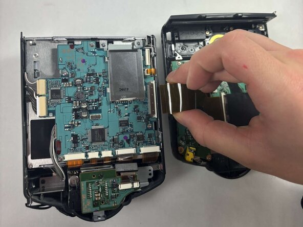

    • Detach the ribbon cable that connects the two halves of the device to split them apart.
    • Gently pry up the black plastic tab to slide out the ribbon cables.
    • Be gentle because this component is thin, but do not be afraid to damage the ribbon cable during removal. Add force progressively in small amounts.

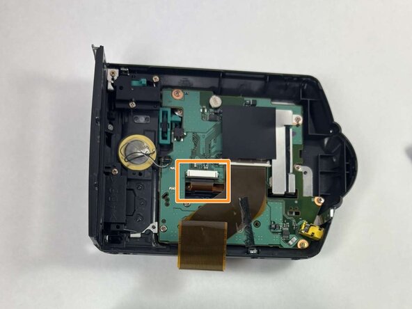

  6. Sony MVC-FD200 LCD Display Screen Replacement: crwdns2935265:06crwdnd2935265:01crwdnd2935265:01crwdne2935265:0
    • Remove the six 2.0 mm screws which hold the motherboard in place using the Phillips #00 screwdriver.
  7. Sony MVC-FD200 LCD Display Screen Replacement: crwdns2935265:07crwdnd2935265:01crwdnd2935265:01crwdne2935265:0
    • Remove the four 2.0 mm screws which hold down the heat shield using the Phillips #00 screwdriver.

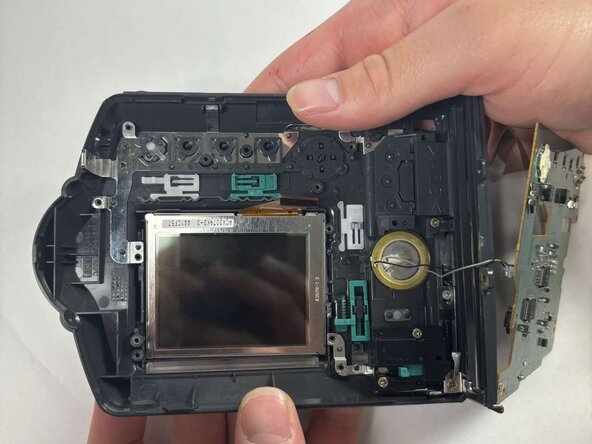

  8. Sony MVC-FD200 LCD Display Screen Replacement: crwdns2935265:08crwdnd2935265:01crwdnd2935265:02crwdne2935265:0 Sony MVC-FD200 LCD Display Screen Replacement: crwdns2935265:08crwdnd2935265:02crwdnd2935265:02crwdne2935265:0
    • The LCD display and the backlight which sits on top of it are displayed.
    • Push both components out.
