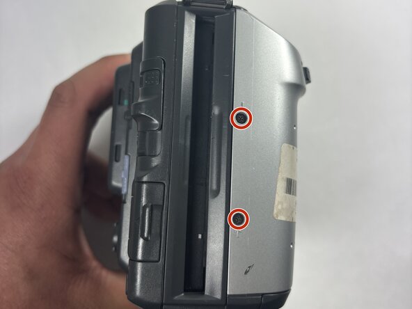

  4. Sony MVC-FD200 Back Cover Replacement: crwdns2935265:04crwdnd2935265:01crwdnd2935265:02crwdne2935265:0 Sony MVC-FD200 Back Cover Replacement: crwdns2935265:04crwdnd2935265:02crwdnd2935265:02crwdne2935265:0
    • Flip the camera on both sides and remove the rest of the screws with arrows facing towards them.
    • Remove the 2.0 mm screws with the Phillips #00 screwdriver for both sides of the camera.
