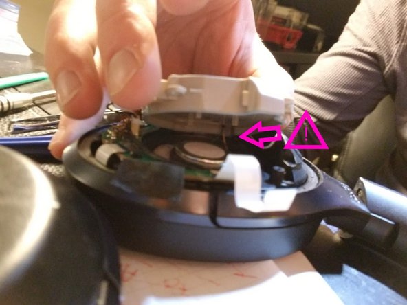

  8. Sony MDR-1000X Noise Cancelling Headphone Teardown, Remove The 4 Screws Holding Down The Beige Mount: crwdns2935265:08crwdnd2935265:01crwdnd2935265:02crwdne2935265:0 Sony MDR-1000X Noise Cancelling Headphone Teardown, Remove The 4 Screws Holding Down The Beige Mount: crwdns2935265:08crwdnd2935265:02crwdnd2935265:02crwdne2935265:0
    • Remove the tape if needed, and then carefully remove the 4 Screws Holding Down The Beige Battery Mount, and the silver screw holding down the main board.
    • Caution!!! The battery mount is wired to cables on the back side of it, do not remove it completely, we just need to gently move the circuit board below.
