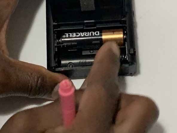

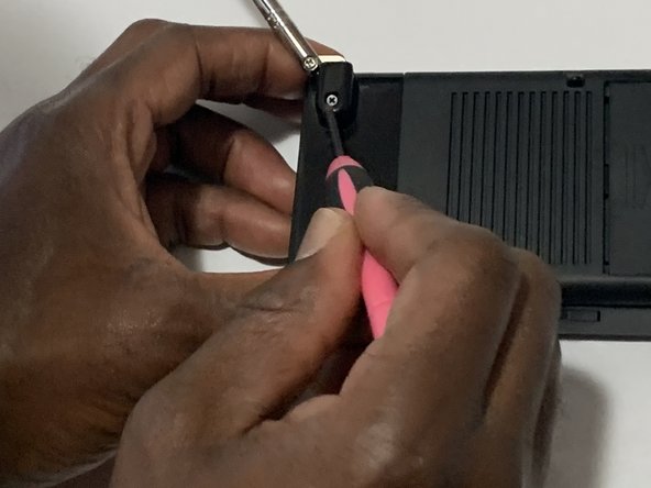

    • Use a mini screwdriver to remove the two screws from the battery compartment.

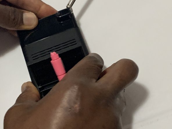

    • Gently insert an opening tool where the FM/AM/Off switch is, to force your way up.
    • Insert the opening tool in the other side where the volume and the earphone go.
    • You will hear hinges pop open.

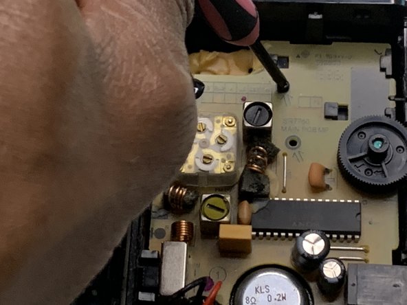

    • Use the mini screwdriver to remove the screw holding the motherboard.
    • Unscrew the damaged antenna.

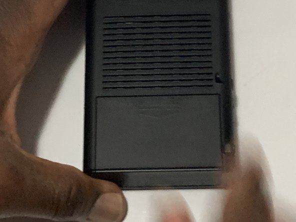

  6. Sony ICF-P26 Antenna Replacement: crwdns2935265:06crwdnd2935265:01crwdnd2935265:03crwdne2935265:0 Sony ICF-P26 Antenna Replacement: crwdns2935265:06crwdnd2935265:02crwdnd2935265:03crwdne2935265:0 Sony ICF-P26 Antenna Replacement: crwdns2935265:06crwdnd2935265:03crwdnd2935265:03crwdne2935265:0
    • Use the mini screwdriver to assemble the cover.
    • Insert the batteries.

Thank you so much. The difficulty is opening the case. You explained it very well. My problem was the dirty potentiometer. I simply poured enough isopropyl alcool on it, to "wash" it, it flowed inside, turn it few times, that was all. Works as new. Thank you.
