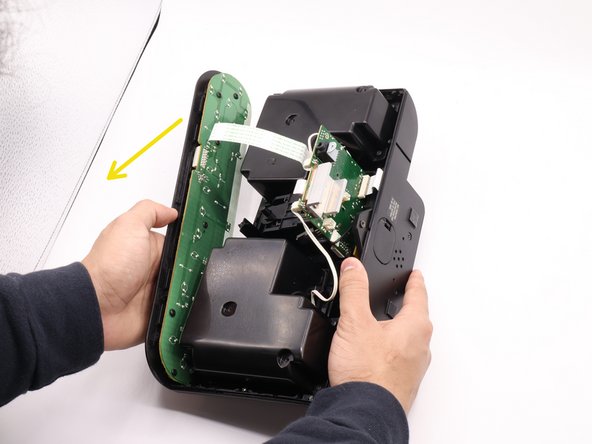

    • Unscrew the 1 cm Phillips #00 screws.
    • Use spudger to loosen the back panel of the device.

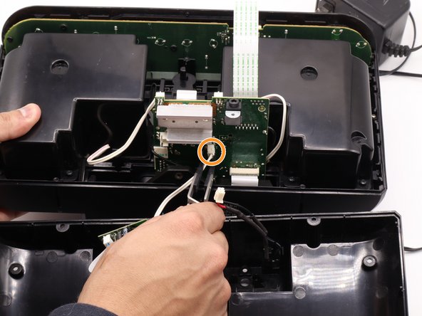

  2. Sony ICF-C1iPMK2 Speaker Replacement: crwdns2935265:02crwdnd2935265:01crwdnd2935265:03crwdne2935265:0 Sony ICF-C1iPMK2 Speaker Replacement: crwdns2935265:02crwdnd2935265:02crwdnd2935265:03crwdne2935265:0 Sony ICF-C1iPMK2 Speaker Replacement: crwdns2935265:02crwdnd2935265:03crwdnd2935265:03crwdne2935265:0
    • This step contains ribbon cables. Be careful to not bend or rip these fragile cables, to protect your device.
    • Slowly pull the back panel off until it separated from the main panel.
    • Carefully unplug all of the ribbon cables connecting the back panel to the main panel.
  3. Sony ICF-C1iPMK2 Speaker Replacement: crwdns2935265:03crwdnd2935265:01crwdnd2935265:03crwdne2935265:0 Sony ICF-C1iPMK2 Speaker Replacement: crwdns2935265:03crwdnd2935265:02crwdnd2935265:03crwdne2935265:0 Sony ICF-C1iPMK2 Speaker Replacement: crwdns2935265:03crwdnd2935265:03crwdnd2935265:03crwdne2935265:0
    • Remove the power connector with a pair of ESD safe tweezers.
    • Remove the Aux port connector with a pair of ESD safe tweezers.
    • Slide the button panels out of the chassis.

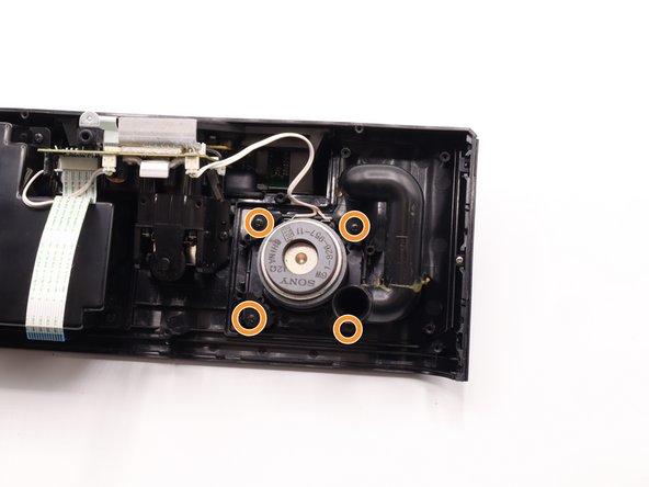

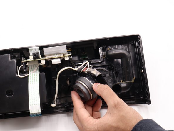

    • Unscrew the four 1 cm Phillips #00 screws and remove the speaker cover.
    • Unscrew the 1 cm Phillips #00 screws holding the speaker in place.
    • Remove the old speaker and insert the new one.
