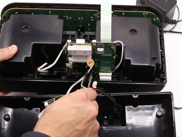

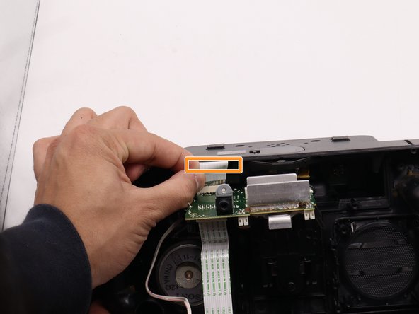

    • This step contains ribbon cables. Be careful to not bend or rip these fragile cables, to protect your device.
    • Open up the back.
    • Carefully remove the ribbon cables by pulling them straight out of the port.
  3. Sony ICF-C1iPMK2 Screen Replacement: crwdns2935265:03crwdnd2935265:01crwdnd2935265:02crwdne2935265:0 Sony ICF-C1iPMK2 Screen Replacement: crwdns2935265:03crwdnd2935265:02crwdnd2935265:02crwdne2935265:0
    • Remove the power connector.
    • Remove the aux cable connector.

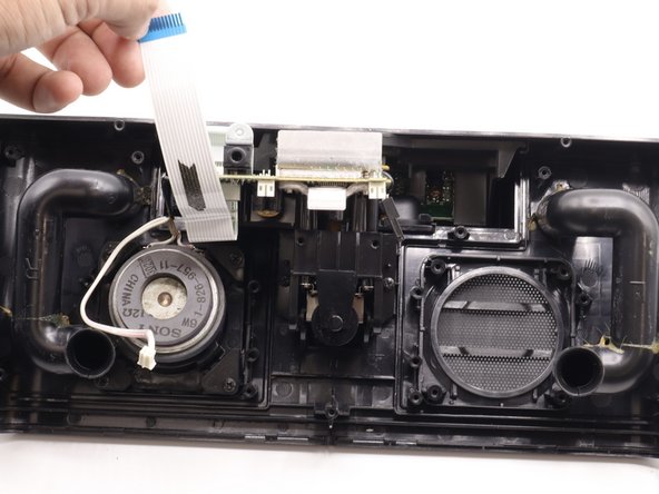

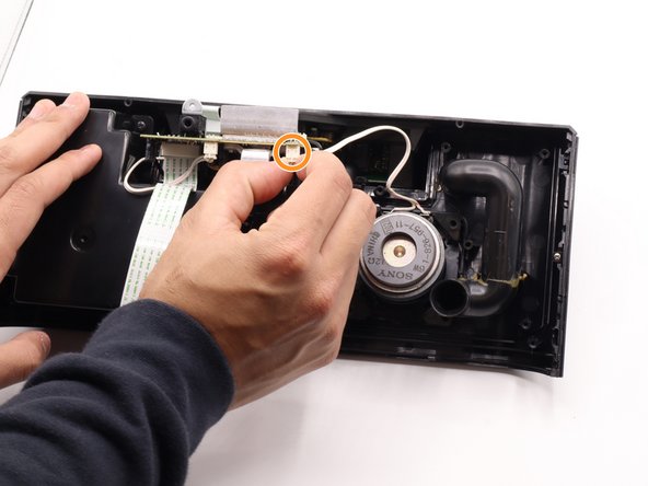

    • Remove the 1 cm screws from the plastic speaker cover using Phillips #00 screwdriver.
    • Gently pull the speaker cable out.
  6. Sony ICF-C1iPMK2 Screen Replacement: crwdns2935265:06crwdnd2935265:01crwdnd2935265:03crwdne2935265:0 Sony ICF-C1iPMK2 Screen Replacement: crwdns2935265:06crwdnd2935265:02crwdnd2935265:03crwdne2935265:0 Sony ICF-C1iPMK2 Screen Replacement: crwdns2935265:06crwdnd2935265:03crwdnd2935265:03crwdne2935265:0

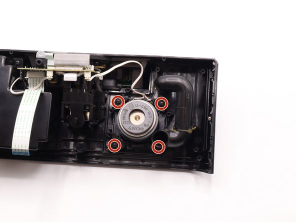

    • Remove the plastic speaker cover from the left side.

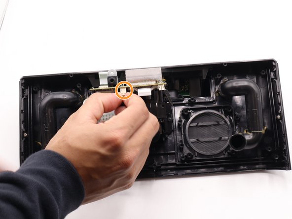

    • Remove the two 1 cm Phillips #00 screws.
    • Carefully pull out the ribbon cable.
    • Slide the iPod dock out.

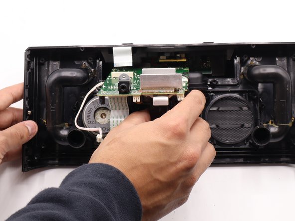

  8. Sony ICF-C1iPMK2 Screen Replacement: crwdns2935265:08crwdnd2935265:01crwdnd2935265:01crwdne2935265:0
    • Gently push down and pull the screen out.
