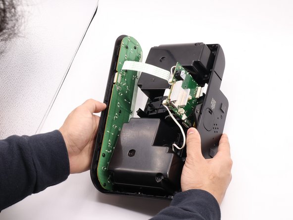

    • Remove the 1 cm Phillips #00 head screws.
    • Use a plastic spudger to pry the back chassis away from the front.
  2. Sony ICF-C1iPMK2 Control Buttons Replacement: crwdns2935265:02crwdnd2935265:01crwdnd2935265:03crwdne2935265:0 Sony ICF-C1iPMK2 Control Buttons Replacement: crwdns2935265:02crwdnd2935265:02crwdnd2935265:03crwdne2935265:0 Sony ICF-C1iPMK2 Control Buttons Replacement: crwdns2935265:02crwdnd2935265:03crwdnd2935265:03crwdne2935265:0

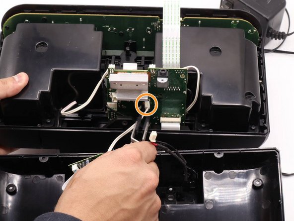

    • This step contains ribbon cables. Be careful to not bend or rip these fragile cables, to protect your device.
    • Open the back chassis.
    • Remove the top ribbon cable by pulling it straight out of the port.
  3. Sony ICF-C1iPMK2 Control Buttons Replacement: crwdns2935265:03crwdnd2935265:01crwdnd2935265:03crwdne2935265:0 Sony ICF-C1iPMK2 Control Buttons Replacement: crwdns2935265:03crwdnd2935265:02crwdnd2935265:03crwdne2935265:0 Sony ICF-C1iPMK2 Control Buttons Replacement: crwdns2935265:03crwdnd2935265:03crwdnd2935265:03crwdne2935265:0
    • Disconnect the power connector.
    • Disconnect the AUX port connector.
    • Slide the buttons out of the front chassis.
