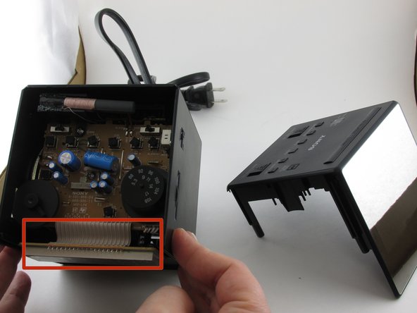

    3. Sony ICF-C1T Volume Dial Replacement: crwdns2935265:03crwdnd2935265:01crwdnd2935265:02crwdne2935265:0 Sony ICF-C1T Volume Dial Replacement: crwdns2935265:03crwdnd2935265:02crwdnd2935265:02crwdne2935265:0
      • Carefully separate the device by gently pulling up on the top of the clock/radio.
      • Use caution when pulling the top of the clock; the clock display is located directly behind the faceplate and still connected by multiple wires.

thanks for the great instructions. a few notes: it seems the “edit” comments were all left in above (“no edits necessary” and the stuff about highlighting parts of it). after step 3, there wasn’t instructions about removing the two screws from the motherboard, before step 4.
