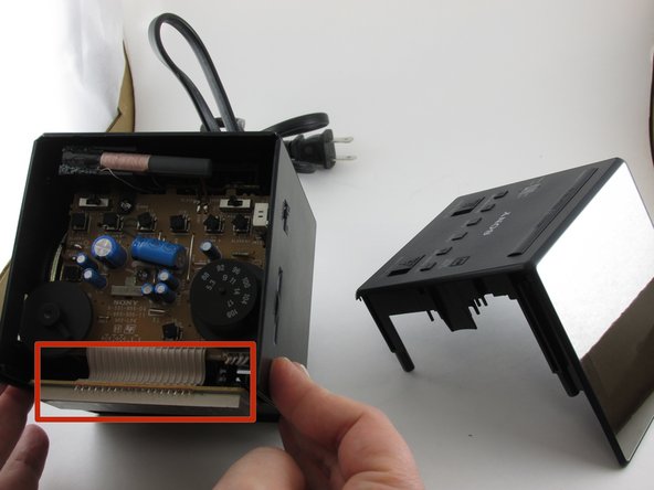

      • Use the opening tool to pry apart the edges of the top and side portions of the device.
    3. Sony ICF-C1T Tuner Dial Replacement: crwdns2935265:03crwdnd2935265:01crwdnd2935265:02crwdne2935265:0 Sony ICF-C1T Tuner Dial Replacement: crwdns2935265:03crwdnd2935265:02crwdnd2935265:02crwdne2935265:0
      • Separate the device by gently pulling up on the top portion.
      • Use caution when pulling the device apart as the clock display is located close to the front face plate and is connected by multiple wires.

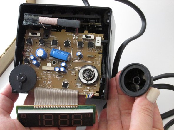

    4. Sony ICF-C1T Tuner Dial Replacement: crwdns2935265:04crwdnd2935265:01crwdnd2935265:02crwdne2935265:0 Sony ICF-C1T Tuner Dial Replacement: crwdns2935265:04crwdnd2935265:02crwdnd2935265:02crwdne2935265:0
      • To remove the motherboard, gently pull apart the sides of the device.
      • Do not pull hard on the motherboard, because it is still connected by multiple wires inside the device.
      • Be careful of sharp pieces on the motherboard.
      • Having help for this step might make things quicker and easier.

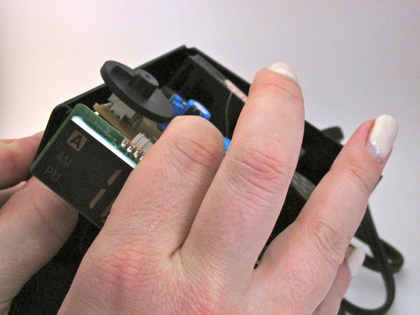

    5. Sony ICF-C1T Tuner Dial Replacement: crwdns2935265:05crwdnd2935265:01crwdnd2935265:03crwdne2935265:0 Sony ICF-C1T Tuner Dial Replacement: crwdns2935265:05crwdnd2935265:02crwdnd2935265:03crwdne2935265:0 Sony ICF-C1T Tuner Dial Replacement: crwdns2935265:05crwdnd2935265:03crwdnd2935265:03crwdne2935265:0
      • Remove the tuner dial by pulling it off of the motherboard. This can take a little force to remove.
