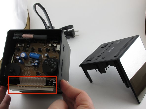

  2. Sony ICF-C1T Speaker Replacement: crwdns2935265:02crwdnd2935265:01crwdnd2935265:01crwdne2935265:0
    • Locate where the top-side of the speaker connects with the sides and use the iFixit Opening Tool to gently pry the top-side off.
  3. Sony ICF-C1T Speaker Replacement: crwdns2935265:03crwdnd2935265:01crwdnd2935265:02crwdne2935265:0 Sony ICF-C1T Speaker Replacement: crwdns2935265:03crwdnd2935265:02crwdnd2935265:02crwdne2935265:0
    • Gently pull the top of the clock away from the rest of the device.
    • Be careful when tugging on this piece of the clock. The clock display is located directly inside the front face and is connected by multiple wires.

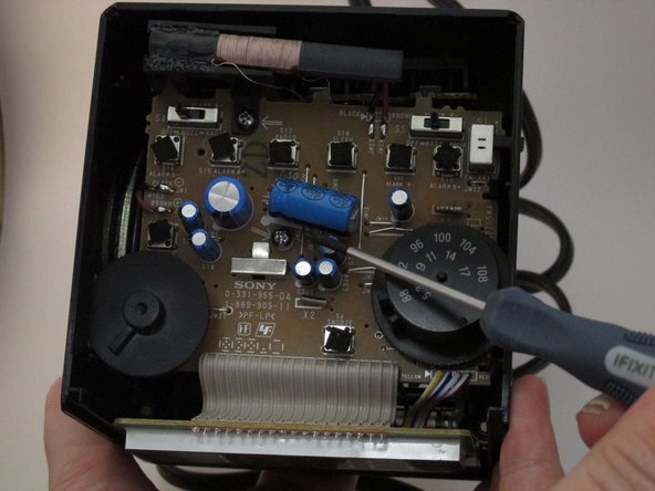

  4. Sony ICF-C1T Speaker Replacement: crwdns2935265:04crwdnd2935265:01crwdnd2935265:02crwdne2935265:0 Sony ICF-C1T Speaker Replacement: crwdns2935265:04crwdnd2935265:02crwdnd2935265:02crwdne2935265:0
    • Using the Phillips #00 screwdriver, remove the two 14mm screws from the top of the motherboard.
    • Be careful to avoid the sharp pieces on the motherboard when handling the device.

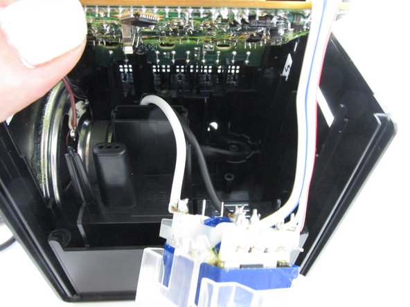

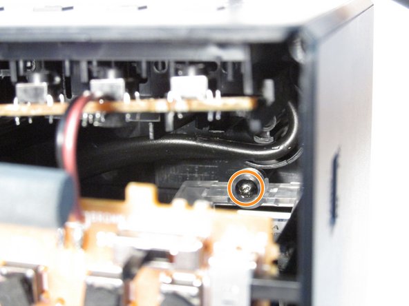

  5. Sony ICF-C1T Speaker Replacement: crwdns2935265:05crwdnd2935265:01crwdnd2935265:03crwdne2935265:0 Sony ICF-C1T Speaker Replacement: crwdns2935265:05crwdnd2935265:02crwdnd2935265:03crwdne2935265:0 Sony ICF-C1T Speaker Replacement: crwdns2935265:05crwdnd2935265:03crwdnd2935265:03crwdne2935265:0
    • Remove the Phillips #00 screw from the bottom of the white and blue box.
    • Remove the Phillips #00 screw from behind the white and blue box.
    • After unscrewing the white box, gently pull it out. This will allow for more room to access the speaker.
  6. Sony ICF-C1T Speaker Replacement: crwdns2935265:06crwdnd2935265:01crwdnd2935265:01crwdne2935265:0
    • To separate the motherboard completely, you can cut the red and black wires that are attached to the speaker. This will allow you to access the speaker fully.
    • Use caution when tampering with the wires and sharp parts of the device.

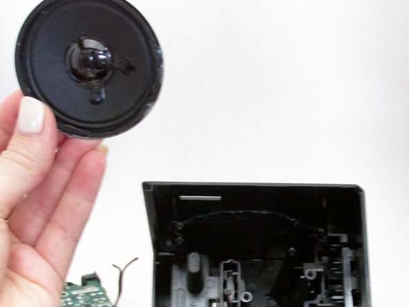

  7. Sony ICF-C1T Speaker Replacement: crwdns2935265:07crwdnd2935265:01crwdnd2935265:02crwdne2935265:0 Sony ICF-C1T Speaker Replacement: crwdns2935265:07crwdnd2935265:02crwdnd2935265:02crwdne2935265:0
    • Use the plastic opening tool and the spudger to separate the speaker from the device by tracing its outline and loosening the glue.
    • Do this step gently as to not damage the device or cause harm to yourself.
    • When reassembling the device, you will need to use glue to place the new speaker back in its place.
    • It would be wise to test the device after reconnecting wires, before screwing and gluing the parts back together.
