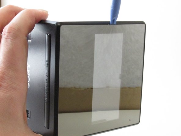

      • Insert the plastic opening tool to pry apart the top and sides of the device gently.

      • Do not use too much pressure on the plastic to not break it.
      • Add pressure to the inside of the screen so that a small area is loosened enough to be able to use an opening tool.
      • Use the plastic opening tool to separate the screen from the device.

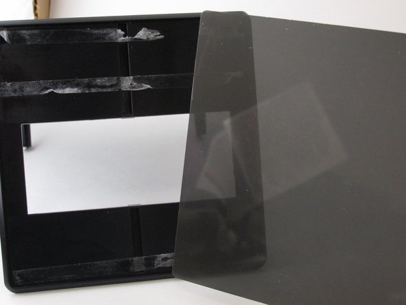

    5. Sony ICF-C1T Screen Replacement: crwdns2935265:05crwdnd2935265:01crwdnd2935265:02crwdne2935265:0 Sony ICF-C1T Screen Replacement: crwdns2935265:05crwdnd2935265:02crwdnd2935265:02crwdne2935265:0
      • Apply a tinted spray to dim the brightness once the tinted sheet is out of the way.
      • Another way to solve the brightness problem is to apply a tinted color sheet protector.
