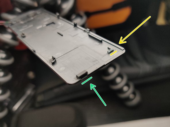

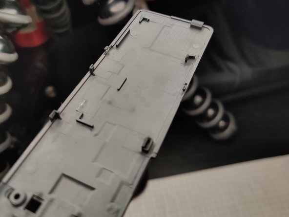

    • I broke the yellow clip, I don't know if it's possible to keep it intact.
    • The green bit holds a metal tooth from the main case: at that point pull the back cover towards the top of the recorder.
    • Using a thin pry tool undo the back cover clips.
    • Start at the top and work your way around.
    • On the side with the USB connector slider there's a strong clip, I suspect at that point you have to pull up towards the top of the recorder. I broke off mine trying but it doesn't show once closed.

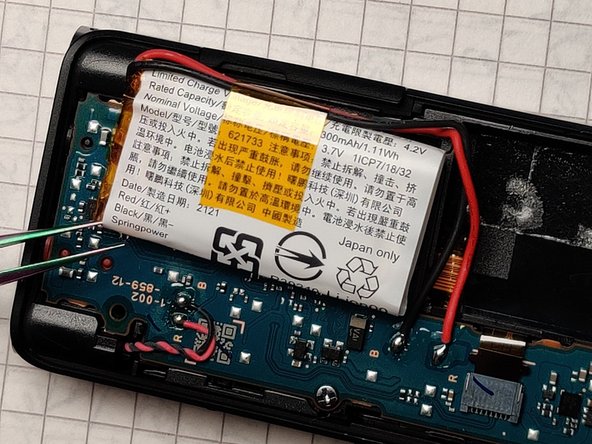

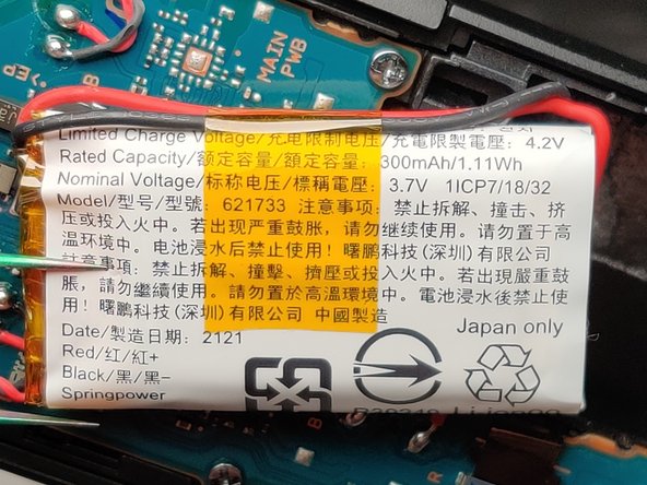

  4. Sony ICD-UX570 Battery Replacement: crwdns2935265:04crwdnd2935265:01crwdnd2935265:03crwdne2935265:0 Sony ICD-UX570 Battery Replacement: crwdns2935265:04crwdnd2935265:02crwdnd2935265:03crwdne2935265:0 Sony ICD-UX570 Battery Replacement: crwdns2935265:04crwdnd2935265:03crwdnd2935265:03crwdne2935265:0
    • Pull up the battery with a pry tool, making sure not to pierce it. It's held down with a bit of double sided tape.
    • Desolder the wires and install the new battery.

Thank you for the great instructions! I just replaced my battery and the new one is charging. The instructions were clear and simple to follow. I am not electrically inclined at all, but this was easy. Instead of soldering, I cut the wires from the old battery near the battery terminal so I had wire to work with. I then tied the new wires to the old ones and used electrical tape. I've never soldered before, so this was an easy alternative. Thank you again!
Steven Laser - crwdns2934203:0crwdne2934203:0
Good thinking. Glad to hear it was useful!
Ugo -
May i ask how did you tie the wires. I don't know how to solder so this method sounds good, but I'm afraid I might fry something by touching it wrong lol
