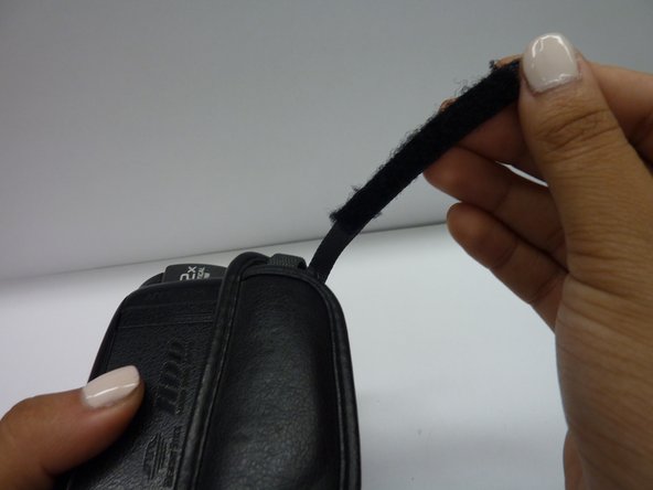

  3. Sony Handycam HDR-XR500V Hard Drive Replacement: crwdns2935265:03crwdnd2935265:01crwdnd2935265:03crwdne2935265:0 Sony Handycam HDR-XR500V Hard Drive Replacement: crwdns2935265:03crwdnd2935265:02crwdnd2935265:03crwdne2935265:0 Sony Handycam HDR-XR500V Hard Drive Replacement: crwdns2935265:03crwdnd2935265:03crwdnd2935265:03crwdne2935265:0
    • Locate the end of the Velcro strap under the harness.
    • Pull the Velcro strap away from camera towards the lens.
    • Pull the harness away from the camera to remove the strap.
