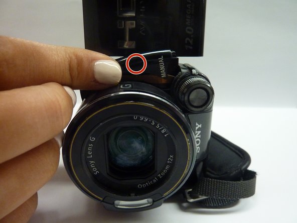

  1. Sony Handycam HDR-XR500V Door Replacement, Opening LCD screen: crwdns2935265:01crwdnd2935265:01crwdnd2935265:02crwdne2935265:0 Sony Handycam HDR-XR500V Door Replacement, Opening LCD screen: crwdns2935265:01crwdnd2935265:02crwdnd2935265:02crwdne2935265:0
    • Pull on tab away from the camera by applying pressure with index finger.

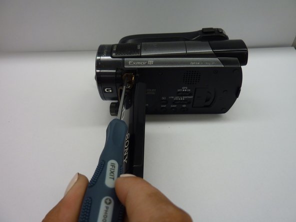

  3. Sony Handycam HDR-XR500V Door Replacement: crwdns2935265:03crwdnd2935265:01crwdnd2935265:03crwdne2935265:0 Sony Handycam HDR-XR500V Door Replacement: crwdns2935265:03crwdnd2935265:02crwdnd2935265:03crwdne2935265:0 Sony Handycam HDR-XR500V Door Replacement: crwdns2935265:03crwdnd2935265:03crwdnd2935265:03crwdne2935265:0
    • Place the camera on a flat service, so that the strap is downward and the lens is facing you.
    • First, lift up the connector.
    • Then pull it back.
    • Remove the connector from the device.

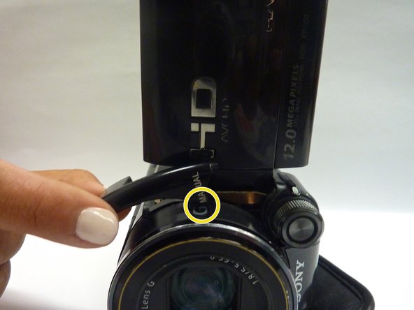

  4. Sony Handycam HDR-XR500V Door Replacement: crwdns2935265:04crwdnd2935265:01crwdnd2935265:02crwdne2935265:0 Sony Handycam HDR-XR500V Door Replacement: crwdns2935265:04crwdnd2935265:02crwdnd2935265:02crwdne2935265:0
    • Position the camera so that the screen tab is pointing towards you.
    • Twist the tab clockwise one notch.
    • Remove the single screw.

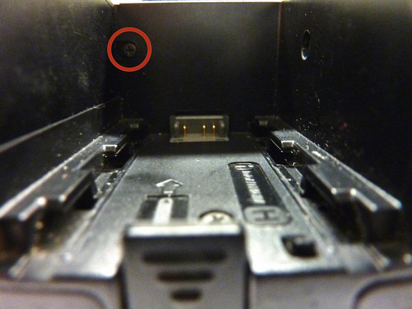

  6. Sony Handycam HDR-XR500V Door Replacement: crwdns2935265:06crwdnd2935265:01crwdnd2935265:02crwdne2935265:0 Sony Handycam HDR-XR500V Door Replacement: crwdns2935265:06crwdnd2935265:02crwdnd2935265:02crwdne2935265:0
    • Place the camera so that the lens is facing downward and the battery compartment is facing towards you.
