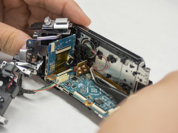

  37. Sony Handycam HDR-CX380 Motherboard Replacement, Motherboard: crwdns2935265:037crwdnd2935265:01crwdnd2935265:01crwdne2935265:0
    • Orient the camera such that the front is facing you.
    • Remove the single 5.5 mm Phillips #00 screw attaching the powerboard to the motherboard.
  38. Sony Handycam HDR-CX380 Motherboard Replacement: crwdns2935265:038crwdnd2935265:01crwdnd2935265:01crwdne2935265:0
    • Remove the three 5.5 mm Phillips #00 screws attaching the motherboard to the camera's hull.
  39. Sony Handycam HDR-CX380 Motherboard Replacement: crwdns2935265:039crwdnd2935265:01crwdnd2935265:02crwdne2935265:0 Sony Handycam HDR-CX380 Motherboard Replacement: crwdns2935265:039crwdnd2935265:02crwdnd2935265:02crwdne2935265:0
    • Orient the camera such that the right side is facing you.
    • With your tweezers in your right hand, gently remove the wire connecting the speaker to the motherboard.
  40. Sony Handycam HDR-CX380 Motherboard Replacement: crwdns2935265:040crwdnd2935265:01crwdnd2935265:01crwdne2935265:0
    • With your tweezers in your right hand, gently pull upward to disconnect the ribbon that runs from the motherboard to the microphone jack.
    • To avoid damaging sensitive electronic equipment, grip only the part of the ribbon which connects directly to the motherboard.

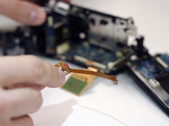

  41. Sony Handycam HDR-CX380 Motherboard Replacement: crwdns2935265:041crwdnd2935265:01crwdnd2935265:01crwdne2935265:0
    • Remove the 5.5 mm Phillips #00 screw above the microphone jack.

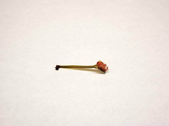

  42. Sony Handycam HDR-CX380 Motherboard Replacement: crwdns2935265:042crwdnd2935265:01crwdnd2935265:03crwdne2935265:0 Sony Handycam HDR-CX380 Motherboard Replacement: crwdns2935265:042crwdnd2935265:02crwdnd2935265:03crwdne2935265:0 Sony Handycam HDR-CX380 Motherboard Replacement: crwdns2935265:042crwdnd2935265:03crwdnd2935265:03crwdne2935265:0
    • Using your left hand to hold the camera, remove the microphone jack with your right thumb and index finger.
    • Try not to touch the ribbon, as doing so may damage sensitive electronic circuits.

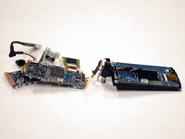

  43. Sony Handycam HDR-CX380 Motherboard Replacement: crwdns2935265:043crwdnd2935265:01crwdnd2935265:02crwdne2935265:0 Sony Handycam HDR-CX380 Motherboard Replacement: crwdns2935265:043crwdnd2935265:02crwdnd2935265:02crwdne2935265:0
    • Using your left hand to hold the camera, remove the motherboard from the camera's hull using your right thumb and index finger.
