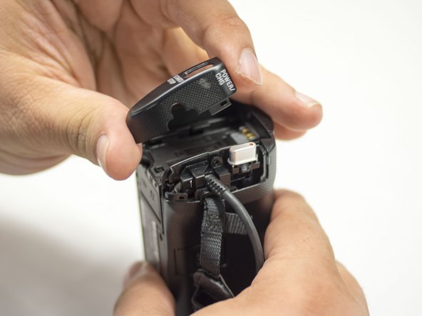

  6. Sony Handycam HDR-CX380 LCD Screen  Replacement: crwdns2935265:06crwdnd2935265:01crwdnd2935265:02crwdne2935265:0 Sony Handycam HDR-CX380 LCD Screen  Replacement: crwdns2935265:06crwdnd2935265:02crwdnd2935265:02crwdne2935265:0
    • With the blue plastic opening tools, gently pry the plastic casing surrounding the start/stop button free.
    • Remove the casing using your right thumb and index finger.

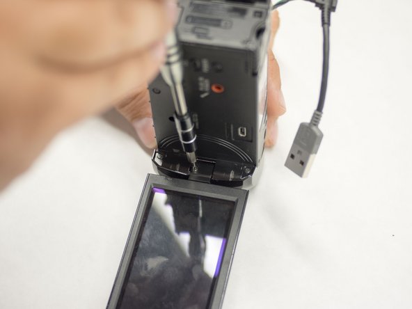

  13. Sony Handycam HDR-CX380 LCD Screen  Replacement: crwdns2935265:013crwdnd2935265:01crwdnd2935265:01crwdne2935265:0
    • Rotate the camera such that the lens is pointed downward and the LCD screen points to your right.
    • Remove the two Phillips #00 screws from the LCD screen's hinge.

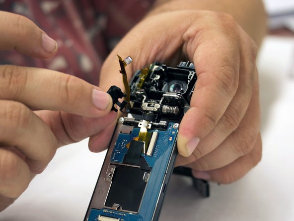

    • Orient the camera such that the bottom is facing toward you and the lens is facing to your right.
    • Using your metal tweezers, gently remove the wire harness connecting the shutter assembly to the motherboard.
  16. Sony Handycam HDR-CX380 LCD Screen  Replacement: crwdns2935265:016crwdnd2935265:01crwdnd2935265:01crwdne2935265:0
    • Rotate the camera so that it is upright and the lens is facing to your right.
    • Remove the ribbon cable connecting the shutter assembly to the motherboard using your metal tweezers.
    • Be sure to pull the ribbon cable gently, as ribbon cables are easy to damage and can require soldering to repair.

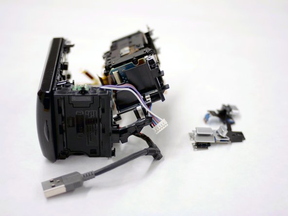

    • Orienting the camera such that the right side is facing you, remove the wire harness connecting the lens assembly to the motherboard using your tweezers.
  25. Sony Handycam HDR-CX380 LCD Screen  Replacement: crwdns2935265:025crwdnd2935265:01crwdnd2935265:01crwdne2935265:0
    • Pull the lens assembly out from inside the camera's hull using your hands.
  26. Sony Handycam HDR-CX380 LCD Screen  Replacement: crwdns2935265:026crwdnd2935265:01crwdnd2935265:02crwdne2935265:0 Sony Handycam HDR-CX380 LCD Screen  Replacement: crwdns2935265:026crwdnd2935265:02crwdnd2935265:02crwdne2935265:0

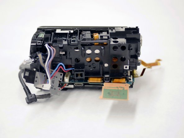

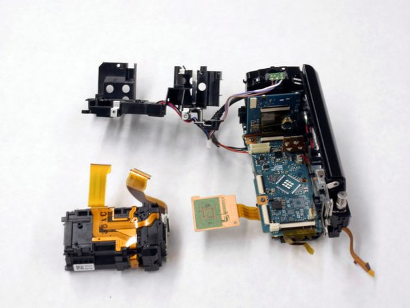

  27. Sony Handycam HDR-CX380 LCD Screen  Replacement: crwdns2935265:027crwdnd2935265:01crwdnd2935265:03crwdne2935265:0 Sony Handycam HDR-CX380 LCD Screen  Replacement: crwdns2935265:027crwdnd2935265:02crwdnd2935265:03crwdne2935265:0 Sony Handycam HDR-CX380 LCD Screen  Replacement: crwdns2935265:027crwdnd2935265:03crwdnd2935265:03crwdne2935265:0
    • Using your tweezers, remove the two ribbon cables connecting the lens assembly to the motherboard.
    • Use metal tweezers to avoid damaging the ribbons.
    • The lens assembly casing should now be free. Remove it from the hull of the camera.

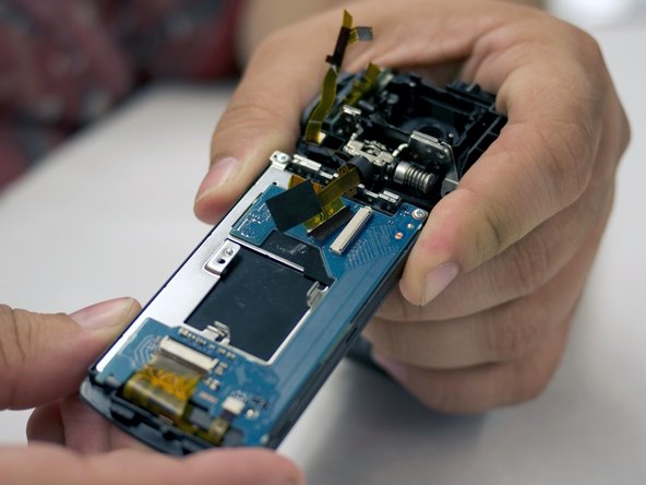

  28. Sony Handycam HDR-CX380 LCD Screen  Replacement: crwdns2935265:028crwdnd2935265:01crwdnd2935265:02crwdne2935265:0 Sony Handycam HDR-CX380 LCD Screen  Replacement: crwdns2935265:028crwdnd2935265:02crwdnd2935265:02crwdne2935265:0
    • Remove the two 4.5 mm Phillips #000 screws connecting the lens assembly to its casing.
    • The lens assembly is now completely free. Remove it from its casing.

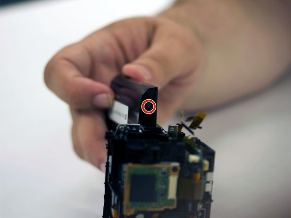

  29. Sony Handycam HDR-CX380 LCD Screen  Replacement, LCD Screen: crwdns2935265:029crwdnd2935265:01crwdnd2935265:02crwdne2935265:0 Sony Handycam HDR-CX380 LCD Screen  Replacement, LCD Screen: crwdns2935265:029crwdnd2935265:02crwdnd2935265:02crwdne2935265:0
    • Rotate the LCD screen on its hinge +/- 90 degrees relative to the camera to expose the screws on the side of the LCD panel.
    • Remove the two 5.5 mm Phillips #00 screws.
  30. Sony Handycam HDR-CX380 LCD Screen  Replacement: crwdns2935265:030crwdnd2935265:01crwdnd2935265:02crwdne2935265:0 Sony Handycam HDR-CX380 LCD Screen  Replacement: crwdns2935265:030crwdnd2935265:02crwdnd2935265:02crwdne2935265:0
    • Remove the single 3 mm Phillips #00 screw from inside of the hinge of the LCD panel.

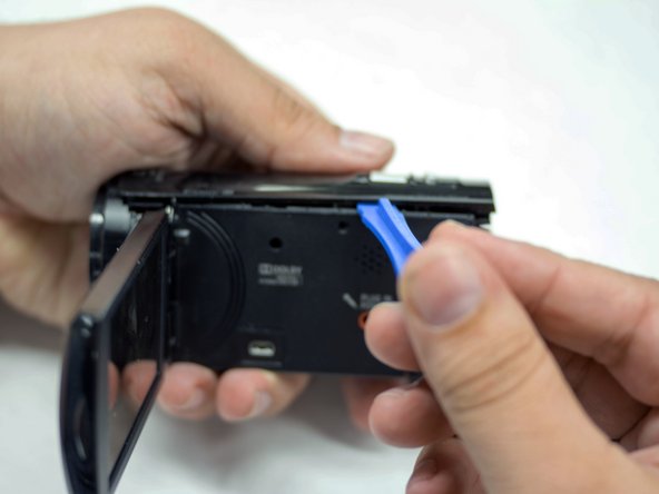

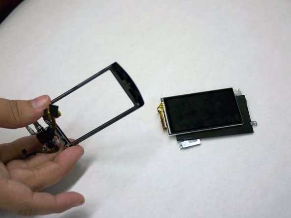

    • Using the plastic opening tools , remove the back panel from the LCD screen.
  32. Sony Handycam HDR-CX380 LCD Screen  Replacement: crwdns2935265:032crwdnd2935265:01crwdnd2935265:02crwdne2935265:0 Sony Handycam HDR-CX380 LCD Screen  Replacement: crwdns2935265:032crwdnd2935265:02crwdnd2935265:02crwdne2935265:0
    • Remove the hinge enclosure from the back of the LCD screen using the blue plastic opening tools.
  33. Sony Handycam HDR-CX380 LCD Screen  Replacement: crwdns2935265:033crwdnd2935265:01crwdnd2935265:02crwdne2935265:0 Sony Handycam HDR-CX380 LCD Screen  Replacement: crwdns2935265:033crwdnd2935265:02crwdnd2935265:02crwdne2935265:0

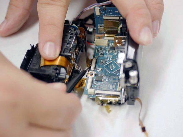

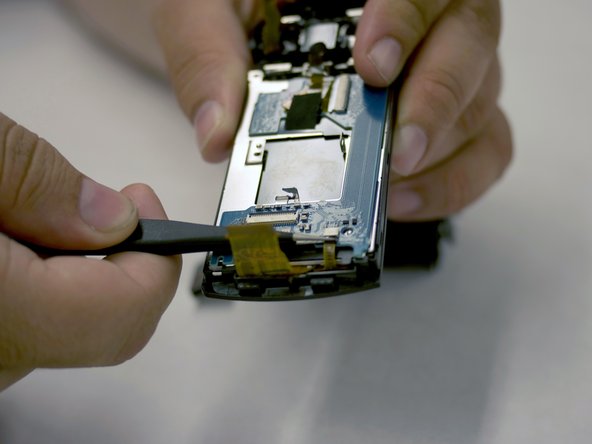

    • With tweezers, remove the ribbon cable that is connecting the LCD screen board to the motherboard.
  34. Sony Handycam HDR-CX380 LCD Screen  Replacement: crwdns2935265:034crwdnd2935265:01crwdnd2935265:02crwdne2935265:0 Sony Handycam HDR-CX380 LCD Screen  Replacement: crwdns2935265:034crwdnd2935265:02crwdnd2935265:02crwdne2935265:0
    • Using metal tweezers, remove the two ribbons connecting the LCD board to the screen.
  35. Sony Handycam HDR-CX380 LCD Screen  Replacement: crwdns2935265:035crwdnd2935265:01crwdnd2935265:01crwdne2935265:0
    • Remove the two silver-colored 4.5 mm Phillips #00 screws from LCD board.

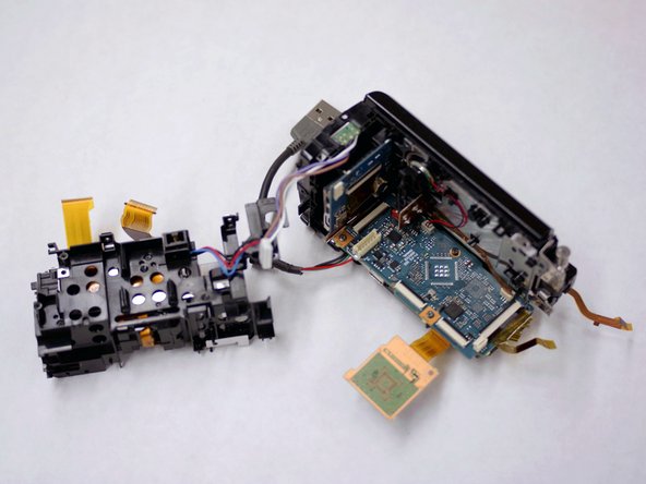

  36. Sony Handycam HDR-CX380 LCD Screen  Replacement: crwdns2935265:036crwdnd2935265:01crwdnd2935265:03crwdne2935265:0 Sony Handycam HDR-CX380 LCD Screen  Replacement: crwdns2935265:036crwdnd2935265:02crwdnd2935265:03crwdne2935265:0 Sony Handycam HDR-CX380 LCD Screen  Replacement: crwdns2935265:036crwdnd2935265:03crwdnd2935265:03crwdne2935265:0
    • The LCD screen and all of its components are free. Unravel them and replace parts as needed (main board, screen, metal fixture, etc.)
