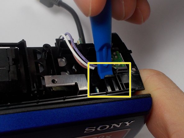

  6. Sony Handycam HDR­-CX220 Motherboard  Replacement, Lens: crwdns2935265:06crwdnd2935265:01crwdnd2935265:03crwdne2935265:0 Sony Handycam HDR­-CX220 Motherboard  Replacement, Lens: crwdns2935265:06crwdnd2935265:02crwdnd2935265:03crwdne2935265:0 Sony Handycam HDR­-CX220 Motherboard  Replacement, Lens: crwdns2935265:06crwdnd2935265:03crwdnd2935265:03crwdne2935265:0
    • Use the Phillips #0 Screwdriver to remove the 5mm screw
    • Use the Plastic Opening tools to unhook the highlighted area.

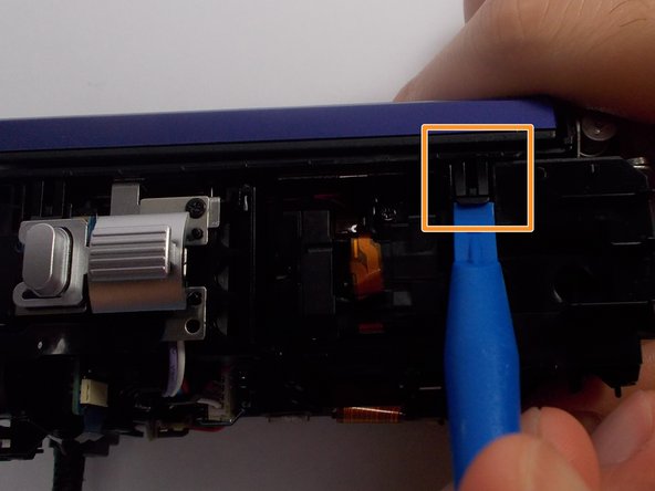

  9. Sony Handycam HDR­-CX220 Motherboard  Replacement, Motherboard: crwdns2935265:09crwdnd2935265:01crwdnd2935265:03crwdne2935265:0 Sony Handycam HDR­-CX220 Motherboard  Replacement, Motherboard: crwdns2935265:09crwdnd2935265:02crwdnd2935265:03crwdne2935265:0 Sony Handycam HDR­-CX220 Motherboard  Replacement, Motherboard: crwdns2935265:09crwdnd2935265:03crwdnd2935265:03crwdne2935265:0
    • Use the Phillips #0 Screwdriver to remove the shown 5mm screws.
    • Use the plastic opening tool to release the front hook.
    • Use the plastic opening tool to release the back hook.

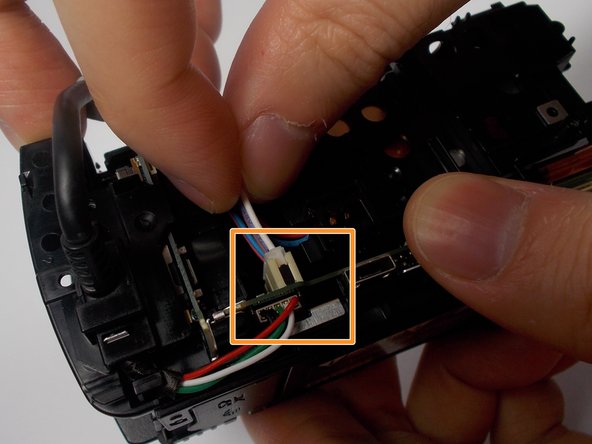

  10. Sony Handycam HDR­-CX220 Motherboard  Replacement: crwdns2935265:010crwdnd2935265:01crwdnd2935265:02crwdne2935265:0 Sony Handycam HDR­-CX220 Motherboard  Replacement: crwdns2935265:010crwdnd2935265:02crwdnd2935265:02crwdne2935265:0
    • Gently pull on the 2 wires shown on the bottom of the camcorder.
    • Disconnect the wire shows on the second picture.

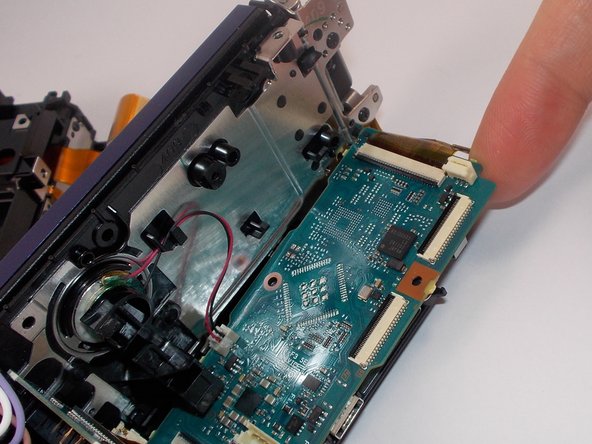

  11. Sony Handycam HDR­-CX220 Motherboard  Replacement: crwdns2935265:011crwdnd2935265:01crwdnd2935265:02crwdne2935265:0 Sony Handycam HDR­-CX220 Motherboard  Replacement: crwdns2935265:011crwdnd2935265:02crwdnd2935265:02crwdne2935265:0
    • Use the Phillips #0 screwdriver to remove the 4mm screw shown.
    • Gently remove the motherboard with your fingers.

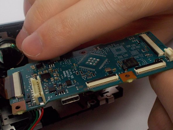

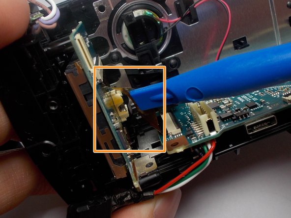

  12. Sony Handycam HDR­-CX220 Motherboard  Replacement: crwdns2935265:012crwdnd2935265:01crwdnd2935265:02crwdne2935265:0 Sony Handycam HDR­-CX220 Motherboard  Replacement: crwdns2935265:012crwdnd2935265:02crwdnd2935265:02crwdne2935265:0
    • Remove the side wire from the motherboard as shown on the photo.
    • Remove the top wire from the motherboard as shown on the photo.
  13. Sony Handycam HDR­-CX220 Motherboard  Replacement: crwdns2935265:013crwdnd2935265:01crwdnd2935265:02crwdne2935265:0 Sony Handycam HDR­-CX220 Motherboard  Replacement: crwdns2935265:013crwdnd2935265:02crwdnd2935265:02crwdne2935265:0
    • Unplug the speaker from the motherboard.
