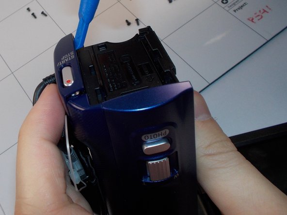

    • Push in the battery indicator.
  2. Sony Handycam HDR­-CX220 Lens Replacement: crwdns2935265:02crwdnd2935265:01crwdnd2935265:01crwdne2935265:0
    • Slide the battery out of the slot.
    • To put the battery back in, line up the battery's metal part with the camera's and slide it in.

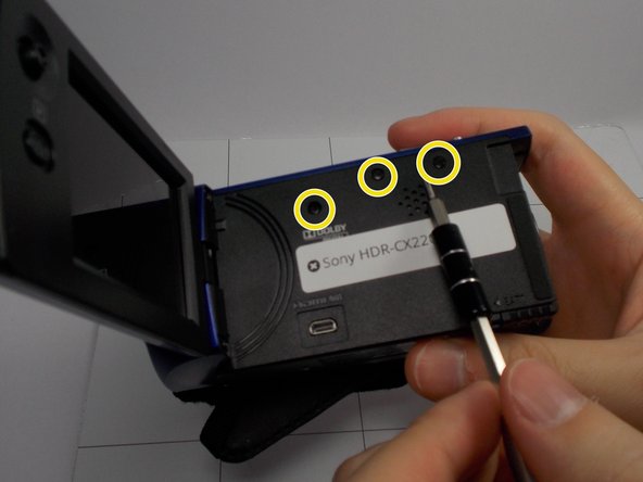

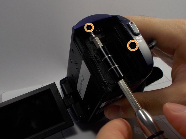

  3. Sony Handycam HDR­-CX220 Lens Replacement, Camera's Body: crwdns2935265:03crwdnd2935265:01crwdnd2935265:03crwdne2935265:0 Sony Handycam HDR­-CX220 Lens Replacement, Camera's Body: crwdns2935265:03crwdnd2935265:02crwdnd2935265:03crwdne2935265:0 Sony Handycam HDR­-CX220 Lens Replacement, Camera's Body: crwdns2935265:03crwdnd2935265:03crwdnd2935265:03crwdne2935265:0
    • Use the Phillips #0 screwdriver to remove the two 5mm screws.
    • Use the Phillips #0 screwdriver to remove the three 5mm screws.

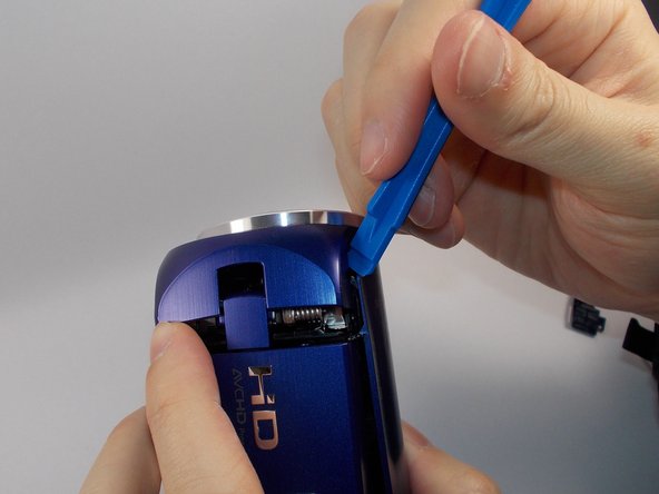

  4. Sony Handycam HDR­-CX220 Lens Replacement: crwdns2935265:04crwdnd2935265:01crwdnd2935265:03crwdne2935265:0 Sony Handycam HDR­-CX220 Lens Replacement: crwdns2935265:04crwdnd2935265:02crwdnd2935265:03crwdne2935265:0 Sony Handycam HDR­-CX220 Lens Replacement: crwdns2935265:04crwdnd2935265:03crwdnd2935265:03crwdne2935265:0
    • Use the plastic opening tool to loosen the plastic case of the camcorder.
  5. Sony Handycam HDR­-CX220 Lens Replacement: crwdns2935265:05crwdnd2935265:01crwdnd2935265:01crwdne2935265:0
    • Use your hands to remove the plastic case.
    • Gently pull on the case not to damage anything internally.
