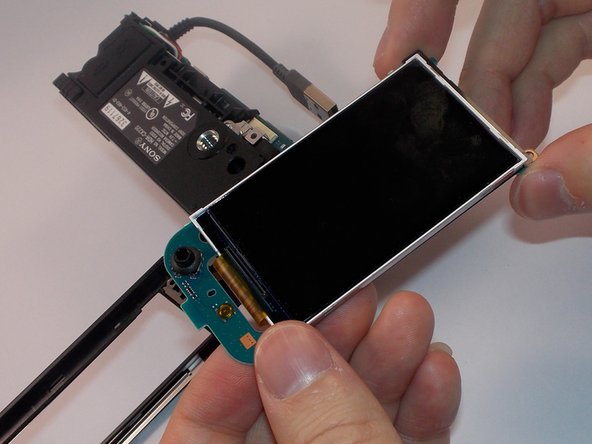

  7. Sony Handycam HDR­-CX220 Display Screen Replacement: crwdns2935265:07crwdnd2935265:01crwdnd2935265:01crwdne2935265:0
    • Use the plastic opening tool to remove the plastic case protecting the screen
    • Pull it gently not to damage anything under the case

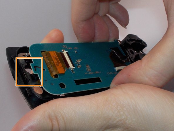

  8. Sony Handycam HDR­-CX220 Display Screen Replacement: crwdns2935265:08crwdnd2935265:01crwdnd2935265:02crwdne2935265:0 Sony Handycam HDR­-CX220 Display Screen Replacement: crwdns2935265:08crwdnd2935265:02crwdnd2935265:02crwdne2935265:0
    • Use the Phillips #0 screwdriver to remove the 2 screws shown
    • Use your hands to carefully unhook the screen from the highlighted hook

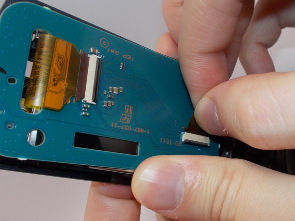

  9. Sony Handycam HDR­-CX220 Display Screen Replacement: crwdns2935265:09crwdnd2935265:01crwdnd2935265:03crwdne2935265:0 Sony Handycam HDR­-CX220 Display Screen Replacement: crwdns2935265:09crwdnd2935265:02crwdnd2935265:03crwdne2935265:0 Sony Handycam HDR­-CX220 Display Screen Replacement: crwdns2935265:09crwdnd2935265:03crwdnd2935265:03crwdne2935265:0
    • Use your hands to carefully remove the tape
    • After removing the tape, pull on the wire disconnecting it from the screen.
