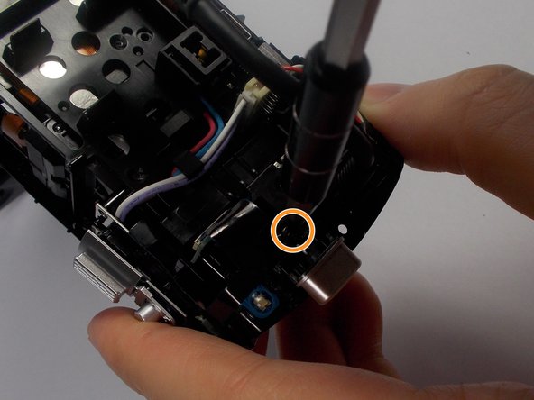

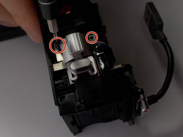

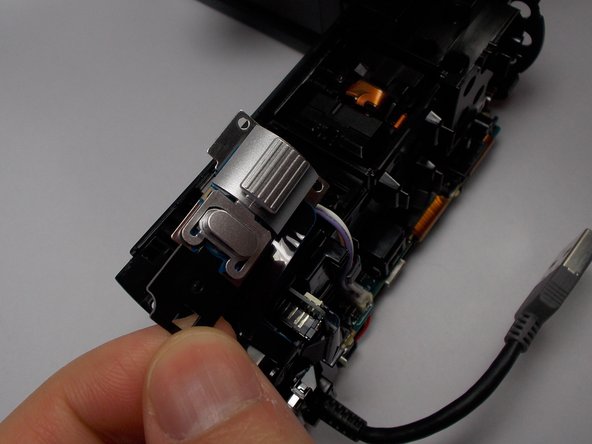

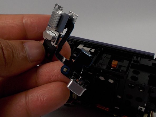

  6. Sony Handycam HDR­-CX220 Buttons  Replacement, Buttons: crwdns2935265:06crwdnd2935265:01crwdnd2935265:03crwdne2935265:0 Sony Handycam HDR­-CX220 Buttons  Replacement, Buttons: crwdns2935265:06crwdnd2935265:02crwdnd2935265:03crwdne2935265:0 Sony Handycam HDR­-CX220 Buttons  Replacement, Buttons: crwdns2935265:06crwdnd2935265:03crwdnd2935265:03crwdne2935265:0
    • Use the Philips #0 screwdriver to unscrew the two 5mm screws shown on top of the camera.
    • Remove the one side 5mm screw using a Philips #0 Screwdriver.
    • Remove the top buttons from the hook.

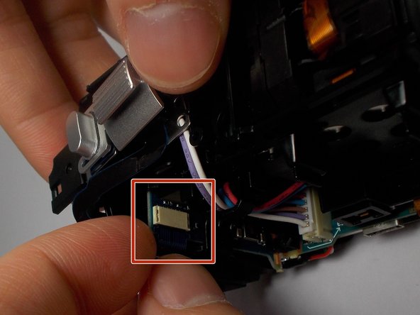

  7. Sony Handycam HDR­-CX220 Buttons  Replacement: crwdns2935265:07crwdnd2935265:01crwdnd2935265:02crwdne2935265:0 Sony Handycam HDR­-CX220 Buttons  Replacement: crwdns2935265:07crwdnd2935265:02crwdnd2935265:02crwdne2935265:0
    • Unplug the connected wire shown.
    • Pull gently not to cause any damage.
