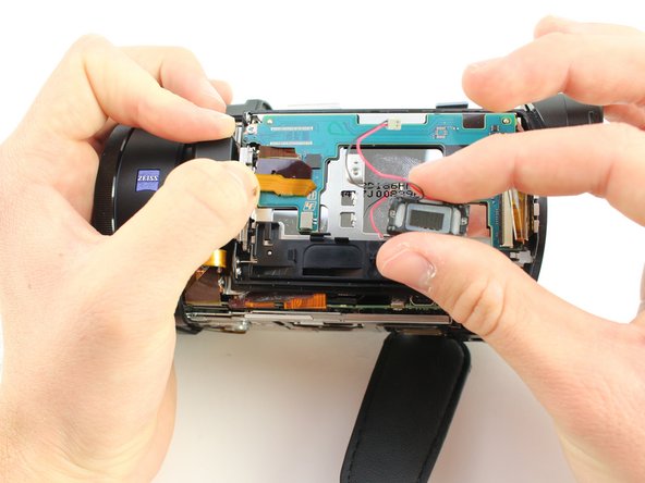

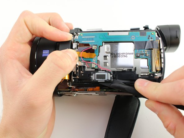

  10. Sony Handycam FDR-AX33 Speaker Replacement: crwdns2935265:010crwdnd2935265:01crwdnd2935265:03crwdne2935265:0 Sony Handycam FDR-AX33 Speaker Replacement: crwdns2935265:010crwdnd2935265:02crwdnd2935265:03crwdne2935265:0 Sony Handycam FDR-AX33 Speaker Replacement: crwdns2935265:010crwdnd2935265:03crwdnd2935265:03crwdne2935265:0
    • Using the tweezers, unplug the speaker. The connector should be a white piece of plastic attached to a red wire and a black wire.
    • Remove the speaker with the black nylon spudger. The speaker is attached by adhesive.
