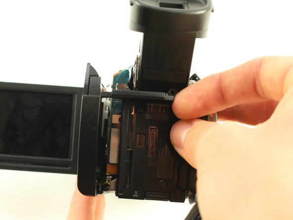

    8. Sony Handycam FDR-AX33 Microphone Replacement: crwdns2935265:08crwdnd2935265:01crwdnd2935265:03crwdne2935265:0 Sony Handycam FDR-AX33 Microphone Replacement: crwdns2935265:08crwdnd2935265:02crwdnd2935265:03crwdne2935265:0 Sony Handycam FDR-AX33 Microphone Replacement: crwdns2935265:08crwdnd2935265:03crwdnd2935265:03crwdne2935265:0
      • Remove the 4 mm Phillips #00 screw above and to the right of the battery slot.
      • Pry the left panel out at an angle by pushing the plastic slat between the battery slot and the eyepiece.
      • Wiggle the left panel and pull it out gently.
      • The left panel can be hard to remove so make sure to apply a good amount of force, but be cautious to not harm yourself or the device.
