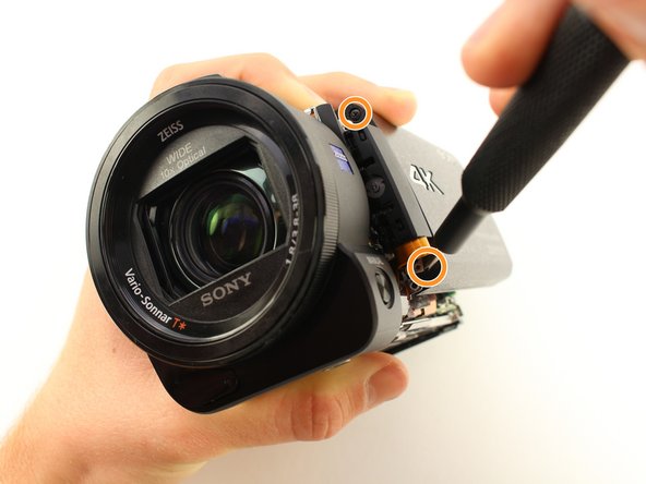

    • Remove the two 4 mm Phillips #00 screws from the top right corner of the camera.
    • Remove the 4 mm Phillips #00 screw from in front of the flash mount.

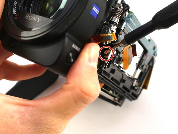

    • Remove the black 3 mm Phillips #00 screw from the middle of the hinge.
    • Remove the two 4 mm Phillips #00 screws from the inside of the screen hinge.

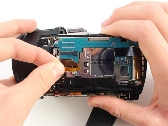

  11. Sony Handycam FDR-AX33 LCD Screen Replacement: crwdns2935265:011crwdnd2935265:01crwdnd2935265:02crwdne2935265:0 Sony Handycam FDR-AX33 LCD Screen Replacement: crwdns2935265:011crwdnd2935265:02crwdnd2935265:02crwdne2935265:0
    • Remove the PCB copper circuits from the blue circuit board by pulling out the flexible plastic connector.
    • The PCB copper circuits are very fragile and break easily, which can irreparably damage your screen.
