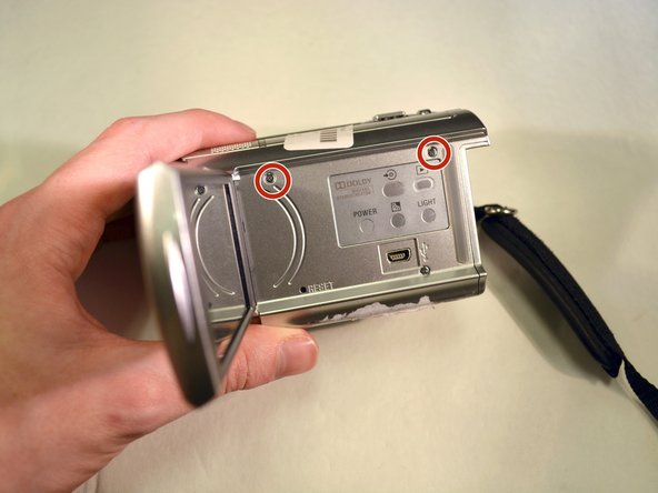

  3. Sony Handycam DCR-SR68 Speaker Replacement: crwdns2935265:03crwdnd2935265:01crwdnd2935265:01crwdne2935265:0
    • Turn device onto it's top with the lens facing right.
    • Unscrew the top left and top right screws.
    • Right side casing is now free.

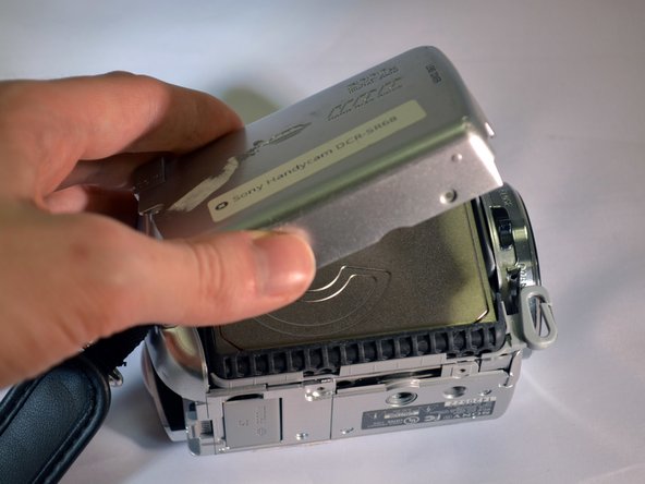

  4. Sony Handycam DCR-SR68 Speaker Replacement: crwdns2935265:04crwdnd2935265:01crwdnd2935265:02crwdne2935265:0 Sony Handycam DCR-SR68 Speaker Replacement: crwdns2935265:04crwdnd2935265:02crwdnd2935265:02crwdne2935265:0
    • Remove the right side casing by pulling away.
    • HDD is now revealed.

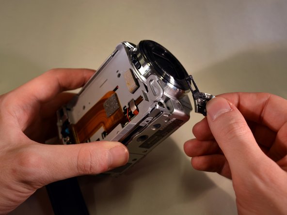

  12. Sony Handycam DCR-SR68 Speaker Replacement: crwdns2935265:012crwdnd2935265:01crwdnd2935265:01crwdne2935265:0
    • Unscrew the top 3 3mm Philips screws from right to left.
  13. Sony Handycam DCR-SR68 Speaker Replacement: crwdns2935265:013crwdnd2935265:01crwdnd2935265:01crwdne2935265:0
    • On the back of the device, unscrew the top 3mm Philips screw.
  14. Sony Handycam DCR-SR68 Speaker Replacement: crwdns2935265:014crwdnd2935265:01crwdnd2935265:02crwdne2935265:0 Sony Handycam DCR-SR68 Speaker Replacement: crwdns2935265:014crwdnd2935265:02crwdnd2935265:02crwdne2935265:0
    • On the left side of the device, unscrew the top 2 3mm Philips screws.
    • The top of the device is now free.

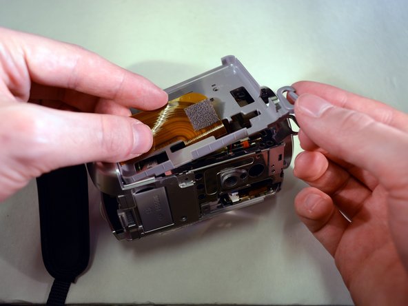

  15. Sony Handycam DCR-SR68 Speaker Replacement: crwdns2935265:015crwdnd2935265:01crwdnd2935265:02crwdne2935265:0 Sony Handycam DCR-SR68 Speaker Replacement: crwdns2935265:015crwdnd2935265:02crwdnd2935265:02crwdne2935265:0
    • Remove the top of the device by lifting it upwards.
    • Be careful of the wires becoming snagged on the frame.

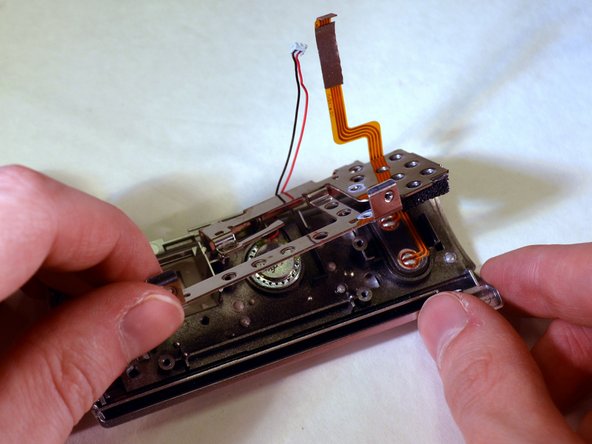

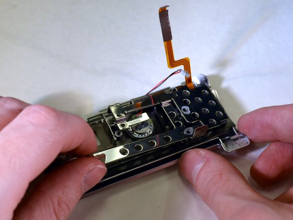

  16. Sony Handycam DCR-SR68 Speaker Replacement: crwdns2935265:016crwdnd2935265:01crwdnd2935265:03crwdne2935265:0 Sony Handycam DCR-SR68 Speaker Replacement: crwdns2935265:016crwdnd2935265:02crwdnd2935265:03crwdne2935265:0 Sony Handycam DCR-SR68 Speaker Replacement: crwdns2935265:016crwdnd2935265:03crwdnd2935265:03crwdne2935265:0
    • With the top of the device in hand, remove the 4 visible 3mm Philips screws.
    • Remove the frame by lifting away.

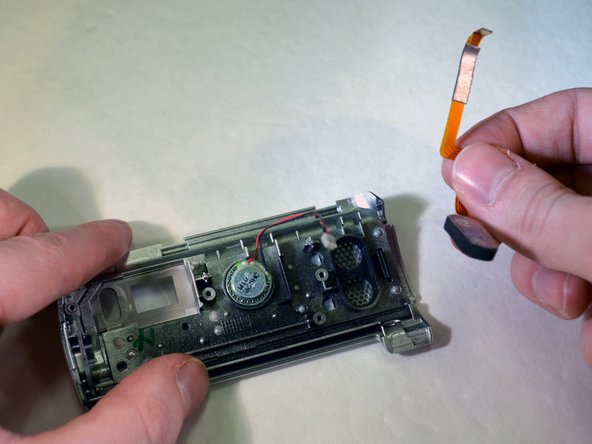

  17. Sony Handycam DCR-SR68 Speaker Replacement: crwdns2935265:017crwdnd2935265:01crwdnd2935265:02crwdne2935265:0 Sony Handycam DCR-SR68 Speaker Replacement: crwdns2935265:017crwdnd2935265:02crwdnd2935265:02crwdne2935265:0
    • The speaker is the object on the right with a ribbon wire connecting to it.
    • Remove the broken speaker with your fingers.
    • Replace with new speaker.
