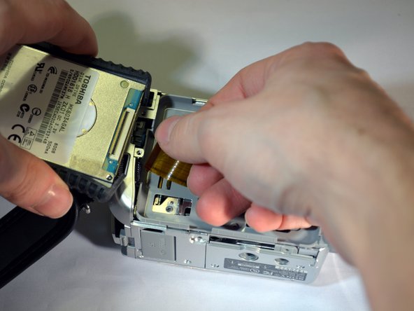

  5. Sony Handycam DCR-SR68 SD Card Slot Replacement: crwdns2935265:05crwdnd2935265:01crwdnd2935265:03crwdne2935265:0 Sony Handycam DCR-SR68 SD Card Slot Replacement: crwdns2935265:05crwdnd2935265:02crwdnd2935265:03crwdne2935265:0 Sony Handycam DCR-SR68 SD Card Slot Replacement: crwdns2935265:05crwdnd2935265:03crwdnd2935265:03crwdne2935265:0
    • Using your fingers, lift the HDD from its right end, pivoting on its left end.
    • The HDD ribbon wire is now exposed.
  6. Sony Handycam DCR-SR68 SD Card Slot Replacement: crwdns2935265:06crwdnd2935265:01crwdnd2935265:02crwdne2935265:0 Sony Handycam DCR-SR68 SD Card Slot Replacement: crwdns2935265:06crwdnd2935265:02crwdnd2935265:02crwdne2935265:0
    • While securely holding the HDD in your left hand, use the soft pad of your right hand fingers to gently pull the ribbon wire out of its socket, toward your right.
    • The HDD is now free from the device.

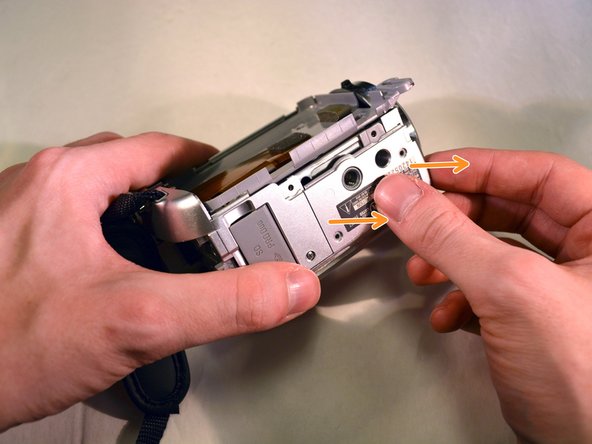

  9. Sony Handycam DCR-SR68 SD Card Slot Replacement: crwdns2935265:09crwdnd2935265:01crwdnd2935265:03crwdne2935265:0 Sony Handycam DCR-SR68 SD Card Slot Replacement: crwdns2935265:09crwdnd2935265:02crwdnd2935265:03crwdne2935265:0 Sony Handycam DCR-SR68 SD Card Slot Replacement: crwdns2935265:09crwdnd2935265:03crwdnd2935265:03crwdne2935265:0
    • On the bottom of the device, use a JIS size #00 precision Phillips screwdriver to remove the 3mm Philips screws on the right side and middle bottom of the bottom case panel.
    • Remove the bottom case panel.

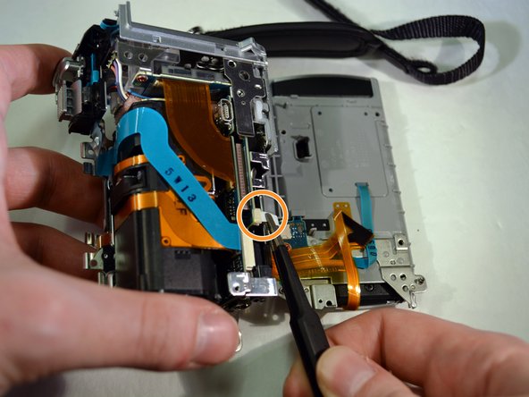

  12. Sony Handycam DCR-SR68 SD Card Slot Replacement: crwdns2935265:012crwdnd2935265:01crwdnd2935265:02crwdne2935265:0 Sony Handycam DCR-SR68 SD Card Slot Replacement: crwdns2935265:012crwdnd2935265:02crwdnd2935265:02crwdne2935265:0
    • Using the pointed black spudger, carefully open the little black clasp on the large ribbon wire port.
    • These claps are known to be fragile.
    • On reassembly, this wire and clasp can be troublesome to reinstall.

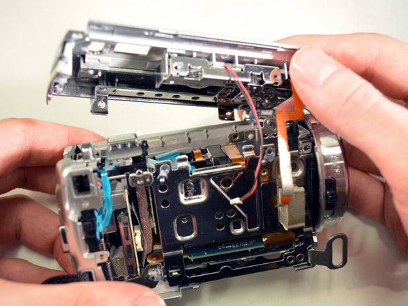

  15. Sony Handycam DCR-SR68 SD Card Slot Replacement: crwdns2935265:015crwdnd2935265:01crwdnd2935265:02crwdne2935265:0 Sony Handycam DCR-SR68 SD Card Slot Replacement: crwdns2935265:015crwdnd2935265:02crwdnd2935265:02crwdne2935265:0
    • Remove the top case panel of the device by lifting up and away./Edits are unnecessary for this step.
    • Set the top case panel aside./Set the device aside.

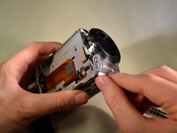

    • Set the device facing forward, with its bottom down.
    • While securing the device with your left hand, use gentle rightward pressure with a plastic opening tool to pop off the shutter assembly. To do this, position the plastic opening tool in the slot labeled in photo one. A close up of the shutter assembly in the picture might help also.

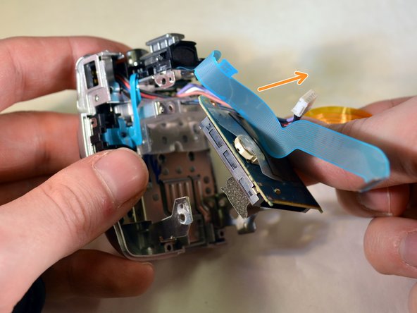

  18. Sony Handycam DCR-SR68 SD Card Slot Replacement: crwdns2935265:018crwdnd2935265:01crwdnd2935265:03crwdne2935265:0 Sony Handycam DCR-SR68 SD Card Slot Replacement: crwdns2935265:018crwdnd2935265:02crwdnd2935265:03crwdne2935265:0 Sony Handycam DCR-SR68 SD Card Slot Replacement: crwdns2935265:018crwdnd2935265:03crwdnd2935265:03crwdne2935265:0
    • On the left side of the device (with the front lens facing left), unscrew the left middle 3mm Philips screw with the screwdriver./A close up of the screw in the picture would be better.
    • Carefully pivot the dismantled piece of the device until the ribbon wires are fully exposed./Carefully pivot the dismantled piece of the device until the ribbon wires are fully exposed.
  19. Sony Handycam DCR-SR68 SD Card Slot Replacement: crwdns2935265:019crwdnd2935265:01crwdnd2935265:03crwdne2935265:0 Sony Handycam DCR-SR68 SD Card Slot Replacement: crwdns2935265:019crwdnd2935265:02crwdnd2935265:03crwdne2935265:0 Sony Handycam DCR-SR68 SD Card Slot Replacement: crwdns2935265:019crwdnd2935265:03crwdnd2935265:03crwdne2935265:0
    • Use the blunt tweezers to unplug the small orange ribbon wire./No edits necessary.
    • Use the same tweezers to unplug the small white ribbon wire./Make a close up of the small white ribbon wire in this picture.
    • The left side of the device is now free./Make this a note/Note: The left side of the device is now free
    • Set the left side of the device in a secure place.

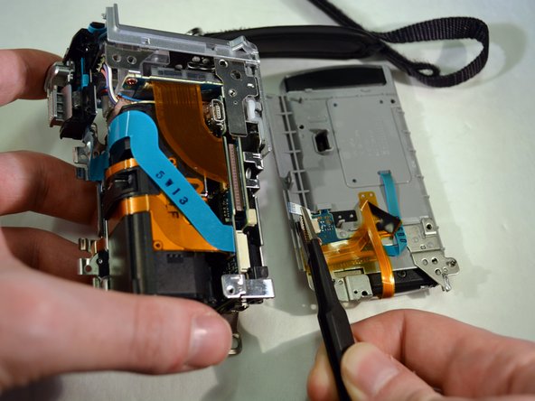

  20. Sony Handycam DCR-SR68 SD Card Slot Replacement: crwdns2935265:020crwdnd2935265:01crwdnd2935265:03crwdne2935265:0 Sony Handycam DCR-SR68 SD Card Slot Replacement: crwdns2935265:020crwdnd2935265:02crwdnd2935265:03crwdne2935265:0 Sony Handycam DCR-SR68 SD Card Slot Replacement: crwdns2935265:020crwdnd2935265:03crwdnd2935265:03crwdne2935265:0
    • Use the blunt tweezers to unplug the blue ribbon wire./No edits necessary.
    • Unplug the orange ribbon wire./no edits necessary.

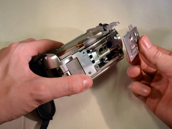

  22. Sony Handycam DCR-SR68 SD Card Slot Replacement: crwdns2935265:022crwdnd2935265:01crwdnd2935265:02crwdne2935265:0 Sony Handycam DCR-SR68 SD Card Slot Replacement: crwdns2935265:022crwdnd2935265:02crwdnd2935265:02crwdne2935265:0
    • On the bottom of the device, remove the last 3mm Philips screw on the last panel./Make a close up of the screw for this picture.
    • Remove the panel./No edits necessary.

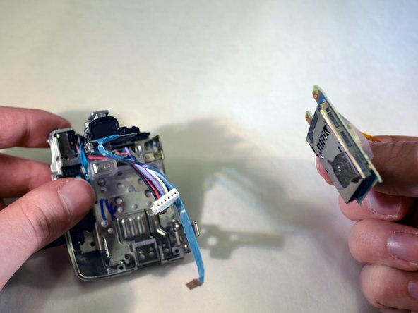

  24. Sony Handycam DCR-SR68 SD Card Slot Replacement: crwdns2935265:024crwdnd2935265:01crwdnd2935265:03crwdne2935265:0 Sony Handycam DCR-SR68 SD Card Slot Replacement: crwdns2935265:024crwdnd2935265:02crwdnd2935265:03crwdne2935265:0 Sony Handycam DCR-SR68 SD Card Slot Replacement: crwdns2935265:024crwdnd2935265:03crwdnd2935265:03crwdne2935265:0
    • Unscrew the two brass 3mm Philips screws with the screwdriver. /Make this picture a close up.
    • Carefully remove the SD card slot, once it's unfastened.
    • The SD card slot is now removed as shown in photo three.
