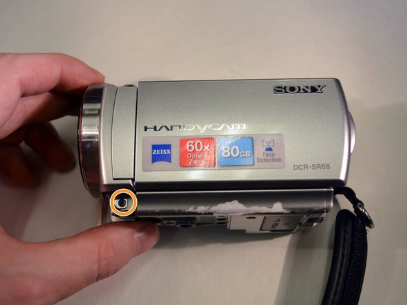

    • Wash and dry your hands, then put on a properly grounded anti-static wrist strap, before handling internal electronic components. To ground the wrist strap, attach it to the metal chassis of a plugged-in three prong power supply, of a computer for example.
    • Unfasten the hand strap.
    • Remove the battery.
  2. Sony Handycam DCR-SR68 LCD Screen Replacement: crwdns2935265:02crwdnd2935265:01crwdnd2935265:02crwdne2935265:0 Sony Handycam DCR-SR68 LCD Screen Replacement: crwdns2935265:02crwdnd2935265:02crwdnd2935265:02crwdne2935265:0
    • Place device on left side with front lens facing right.
    • Using a JIS size #00 precision Phillips screwdriver, unscrew the left middle 3mm Phillips screw.
    • Open the "DC IN" plastic tab (Second 3mm Phillips screw is revealed).
    • Unscrew the second 3mm Phillips screw.

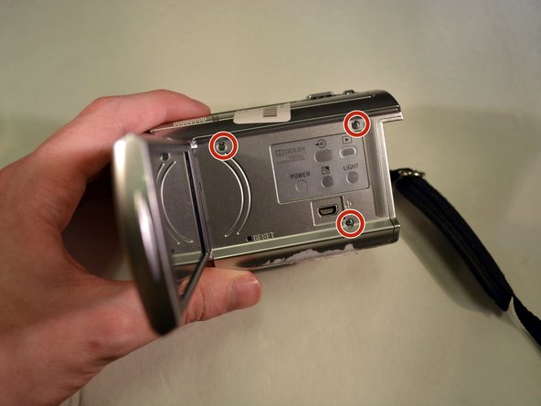

    • On the left side of the device, remove all visible 3mm Philips screws.

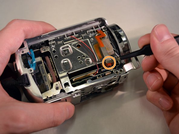

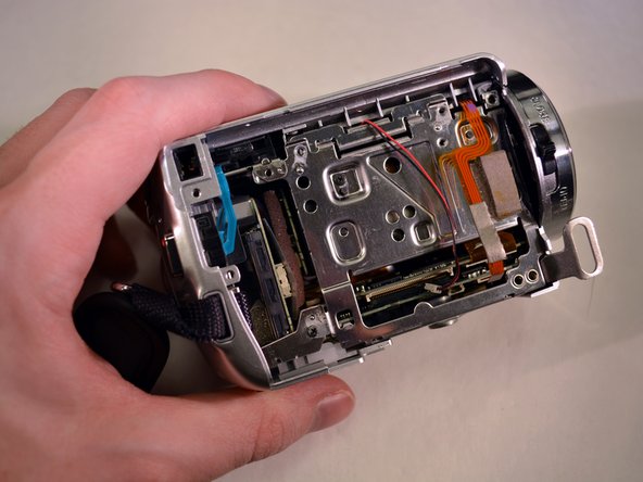

    • Using the black spudger, carefully open the little black clasp on the large ribbon wire port.
    • These clasps are known to be fragile.
    • On reassembly, this wire and clasp can be troublesome to reinstall.
  13. Sony Handycam DCR-SR68 LCD Screen Replacement: crwdns2935265:013crwdnd2935265:01crwdnd2935265:03crwdne2935265:0 Sony Handycam DCR-SR68 LCD Screen Replacement: crwdns2935265:013crwdnd2935265:02crwdnd2935265:03crwdne2935265:0 Sony Handycam DCR-SR68 LCD Screen Replacement: crwdns2935265:013crwdnd2935265:03crwdnd2935265:03crwdne2935265:0
    • Using the blunt tweezers, unplug the red and black wire by gently pulling out and away.
    • Unplug the small ribbon wire.
  14. Sony Handycam DCR-SR68 LCD Screen Replacement: crwdns2935265:014crwdnd2935265:01crwdnd2935265:01crwdne2935265:0
    • On the right side of the device, remove the top three right 3mm Philips screws.
  15. Sony Handycam DCR-SR68 LCD Screen Replacement: crwdns2935265:015crwdnd2935265:01crwdnd2935265:01crwdne2935265:0
    • On the back of the device, remove the top 3mm Philips screw.
    • The top of the device is now free.

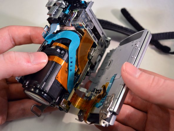

  16. Sony Handycam DCR-SR68 LCD Screen Replacement: crwdns2935265:016crwdnd2935265:01crwdnd2935265:02crwdne2935265:0 Sony Handycam DCR-SR68 LCD Screen Replacement: crwdns2935265:016crwdnd2935265:02crwdnd2935265:02crwdne2935265:0
    • Remove top of device by lifting up and away.
  17. Sony Handycam DCR-SR68 LCD Screen Replacement: crwdns2935265:017crwdnd2935265:01crwdnd2935265:02crwdne2935265:0 Sony Handycam DCR-SR68 LCD Screen Replacement: crwdns2935265:017crwdnd2935265:02crwdnd2935265:02crwdne2935265:0
    • On the top of the device, remove the top right 3mm Philips screw.
    • On the left side of the device, remove the bottom left 3mm Philips screw.
  18. Sony Handycam DCR-SR68 LCD Screen Replacement: crwdns2935265:018crwdnd2935265:01crwdnd2935265:02crwdne2935265:0 Sony Handycam DCR-SR68 LCD Screen Replacement: crwdns2935265:018crwdnd2935265:02crwdnd2935265:02crwdne2935265:0

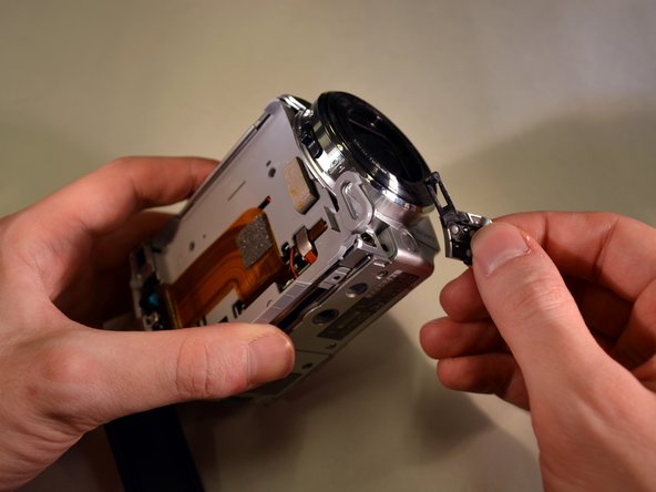

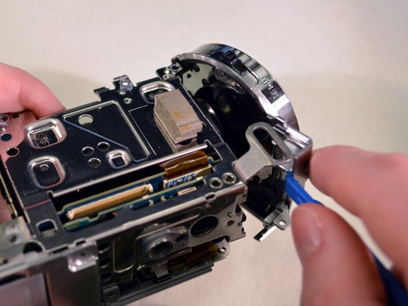

    • Use the blue plastic opening tool to pop the shutter assembly off the device.
  19. Sony Handycam DCR-SR68 LCD Screen Replacement: crwdns2935265:019crwdnd2935265:01crwdnd2935265:01crwdne2935265:0

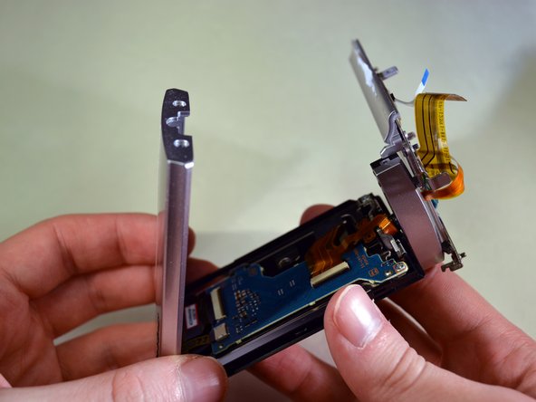

    • Carefully pivot the loose left side of the device until the ribbon wires are fully exposed.
  21. Sony Handycam DCR-SR68 LCD Screen Replacement: crwdns2935265:021crwdnd2935265:01crwdnd2935265:03crwdne2935265:0 Sony Handycam DCR-SR68 LCD Screen Replacement: crwdns2935265:021crwdnd2935265:02crwdnd2935265:03crwdne2935265:0 Sony Handycam DCR-SR68 LCD Screen Replacement: crwdns2935265:021crwdnd2935265:03crwdnd2935265:03crwdne2935265:0
    • Using the blunt tweezers, unplug the small orange ribbon wire.
    • Unplug the small white ribbon wire.
    • The left side of the device is now free.

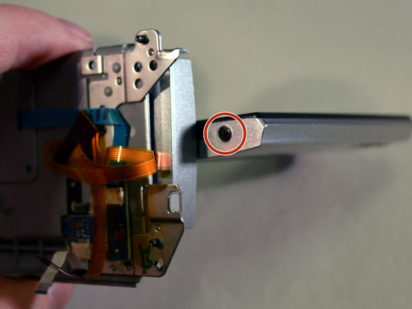

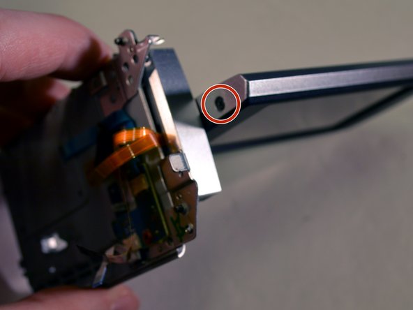

    • Open the screen and rotate it 90 degrees until the two black screws are exposed.
    • Remove the two black 3mm Philips screws.

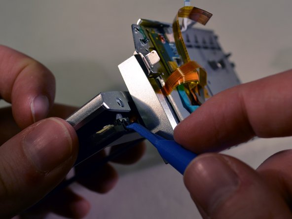

    • Use a plastic opening tool to pop open the casing around the screen.
    • The casing may require some finesse to pop open.

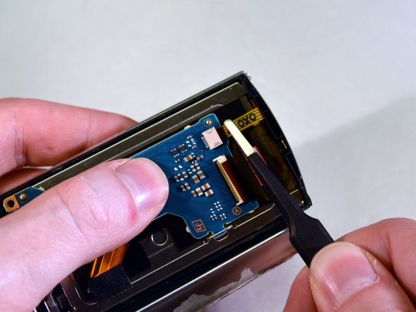

    • Use the blunt tweezers to unplug both right side ribbon wires.
  26. Sony Handycam DCR-SR68 LCD Screen Replacement: crwdns2935265:026crwdnd2935265:01crwdnd2935265:02crwdne2935265:0 Sony Handycam DCR-SR68 LCD Screen Replacement: crwdns2935265:026crwdnd2935265:02crwdnd2935265:02crwdne2935265:0
    • Lift the framework up and pivot to the left.
    • The screen is now expose.

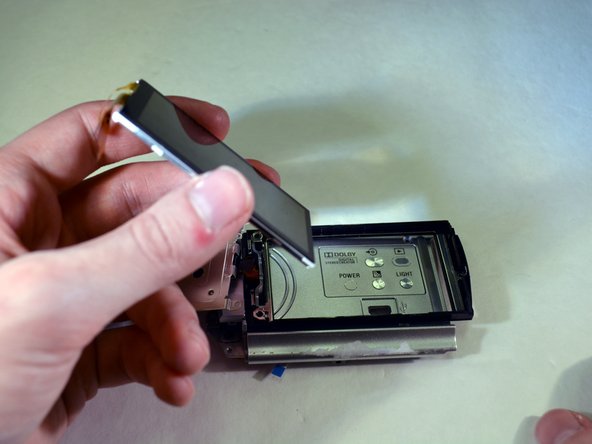

  27. Sony Handycam DCR-SR68 LCD Screen Replacement: crwdns2935265:027crwdnd2935265:01crwdnd2935265:02crwdne2935265:0 Sony Handycam DCR-SR68 LCD Screen Replacement: crwdns2935265:027crwdnd2935265:02crwdnd2935265:02crwdne2935265:0
    • Lift out the screen by grabbing the ribbon wire and lifting up and out.
