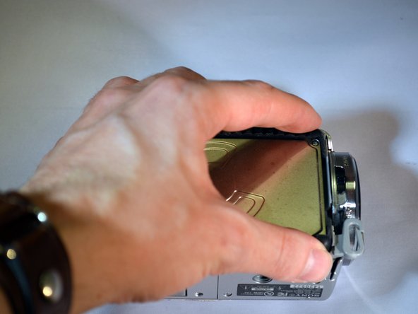

    • Place device on left side with lens facing right.
    • Using the screwdriver, unscrew the left middle 3mm Philips screw.
    • Open the "DC IN" tabe. (Second 3mm Philips screw is revealed)
    • Unscrew this screw.
