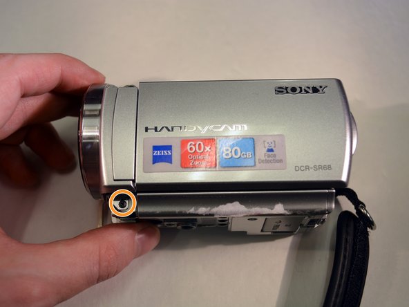

    • Place device on left side with front lens facing right.
    • Using a JIS size #00 precision Phillips screwdriver, unscrew the left middle 3mm Phillips screw.
    • Open the "DC IN" plastic tab (Second 3mm Phillips screw is revealed).
    • Unscrew the second 3mm Phillips screw.

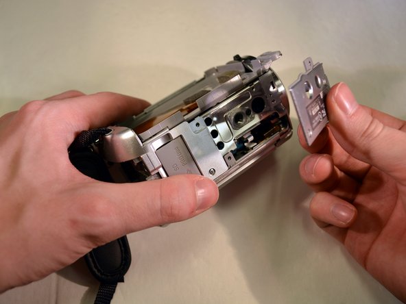

    • On the bottom of the device, remove the right and middle bottom 3mm Philips screws.
    • Remove the panel.

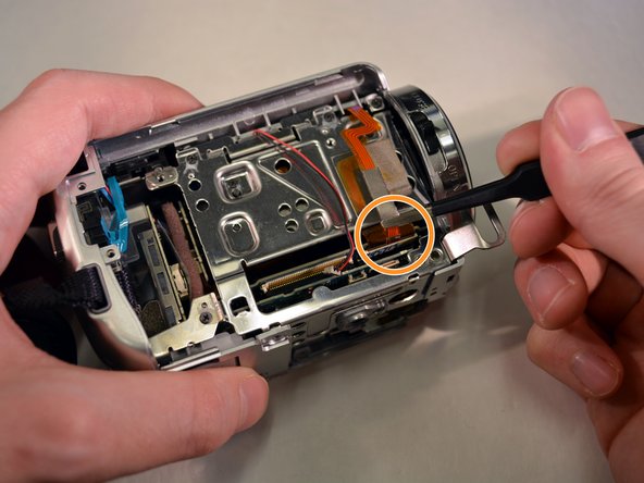

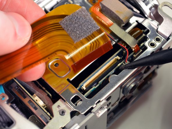

    • Using the pointed black spudger, carefully open the little black clasp on the large ribbon wire port.
    • These clasps are known to be fragile.
    • On reassembly, this wire and clasp can be troublesome to reinstall.New line.
  13. Sony Handycam DCR-SR68  Lens replacment Replacement: crwdns2935265:013crwdnd2935265:01crwdnd2935265:03crwdne2935265:0 Sony Handycam DCR-SR68  Lens replacment Replacement: crwdns2935265:013crwdnd2935265:02crwdnd2935265:03crwdne2935265:0 Sony Handycam DCR-SR68  Lens replacment Replacement: crwdns2935265:013crwdnd2935265:03crwdnd2935265:03crwdne2935265:0
    • Use the blunt tweezers to unplug the red and black wire by pulling out and away.
    • Unplug the small ribbon wire.

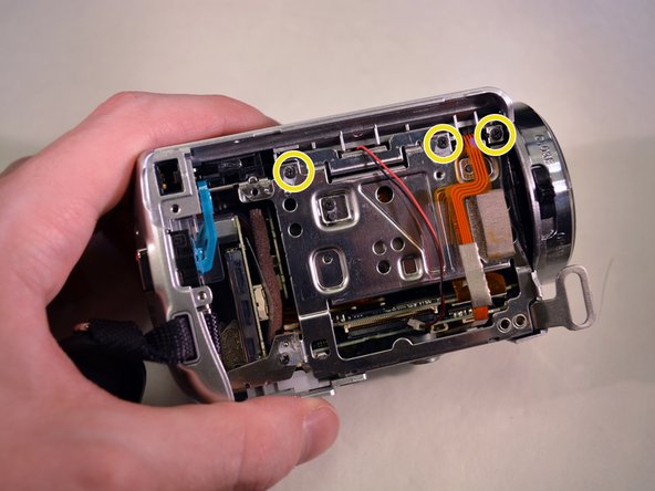

    • Unscrew the two right three 3mm Philips screws.

    • On the top of the device, unscrew the top right 3mm Philips screw.
    • On the left side of the device, unscrew the bottom left 3mm Philips screw.

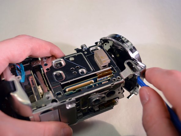

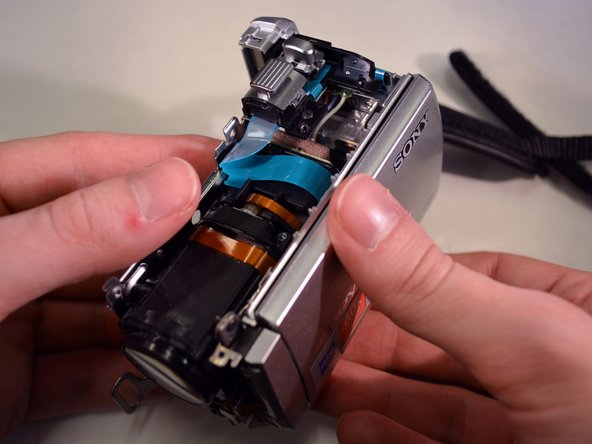

    • Use a plastic opening tool to pop off the shutter assembly.
  18. Sony Handycam DCR-SR68  Lens replacment Replacement: crwdns2935265:018crwdnd2935265:01crwdnd2935265:03crwdne2935265:0 Sony Handycam DCR-SR68  Lens replacment Replacement: crwdns2935265:018crwdnd2935265:02crwdnd2935265:03crwdne2935265:0 Sony Handycam DCR-SR68  Lens replacment Replacement: crwdns2935265:018crwdnd2935265:03crwdnd2935265:03crwdne2935265:0

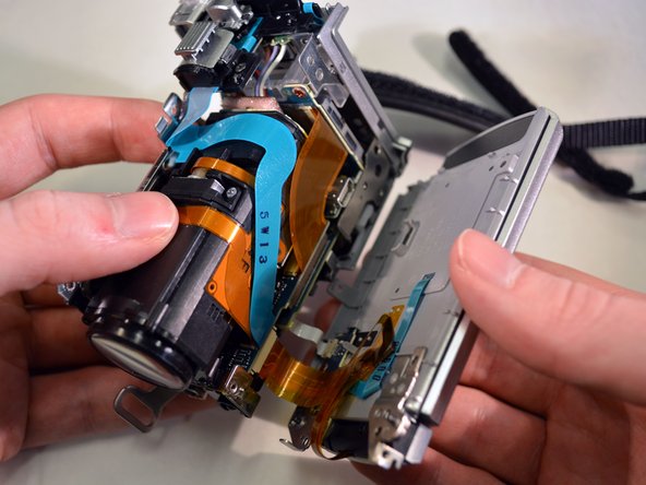

    • On the left side of the device, unscrew the left middle 3mm Philips screw.
    • Carefully pivot the loose left side of the device until the ribbon wires are fully exposed.
  19. Sony Handycam DCR-SR68  Lens replacment Replacement: crwdns2935265:019crwdnd2935265:01crwdnd2935265:03crwdne2935265:0 Sony Handycam DCR-SR68  Lens replacment Replacement: crwdns2935265:019crwdnd2935265:02crwdnd2935265:03crwdne2935265:0 Sony Handycam DCR-SR68  Lens replacment Replacement: crwdns2935265:019crwdnd2935265:03crwdnd2935265:03crwdne2935265:0
    • Use the blunt tweezers to unplug the small orange ribbon wire.
    • Unplug the small white ribbon wire.
    • The left side of the device is now free.
    • Set aside.

    • The lens module is connected to the device by an adhesive foam backing.
    • Pull the lens module away from the adhesive foam backing until it's releases.
    • Don't pull it too far as there is one more ribbon wire connected to it.

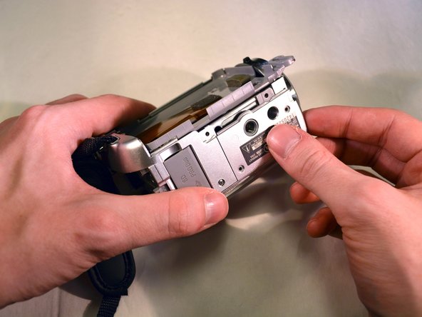

  23. Sony Handycam DCR-SR68  Lens replacment Replacement: crwdns2935265:023crwdnd2935265:01crwdnd2935265:01crwdne2935265:0
    • Unplug this ribbon wire with your fingers or tweezers.
    • This wire can be tricky to get to.
  24. Sony Handycam DCR-SR68  Lens replacment Replacement: crwdns2935265:024crwdnd2935265:01crwdnd2935265:01crwdne2935265:0
    • With the old lens module removed, the new one can be installed.
To reassemble your device, follow these instructions in reverse order in addition to the HDD replacement guide.
