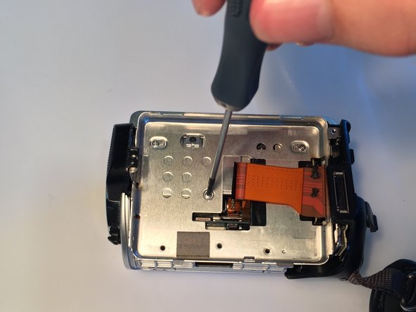

    • Remove the four 3mm Phillips #00 screws from under the hard drive.
  9. Sony Handycam DCR-SR42 Lens Replacement: crwdns2935265:09crwdnd2935265:01crwdnd2935265:03crwdne2935265:0 Sony Handycam DCR-SR42 Lens Replacement: crwdns2935265:09crwdnd2935265:02crwdnd2935265:03crwdne2935265:0 Sony Handycam DCR-SR42 Lens Replacement: crwdns2935265:09crwdnd2935265:03crwdnd2935265:03crwdne2935265:0
    • Press in on the two tabs as shown and lift the metal plate up and off the camera.
    • Even with all the screws removed, this part will require some force to remove.

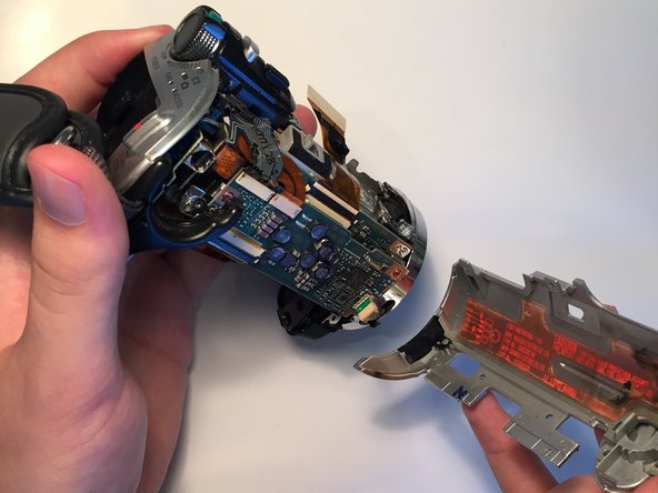

  17. Sony Handycam DCR-SR42 Lens Replacement: crwdns2935265:017crwdnd2935265:01crwdnd2935265:01crwdne2935265:0
    • Remove the lens housing from the camera.
  18. Sony Handycam DCR-SR42 Lens Replacement: crwdns2935265:018crwdnd2935265:01crwdnd2935265:01crwdne2935265:0
    • Remove the three 2mm Phillips #00 screws from around the lens.
  19. Sony Handycam DCR-SR42 Lens Replacement: crwdns2935265:019crwdnd2935265:01crwdnd2935265:01crwdne2935265:0
    • Remove the lens from the camera.
