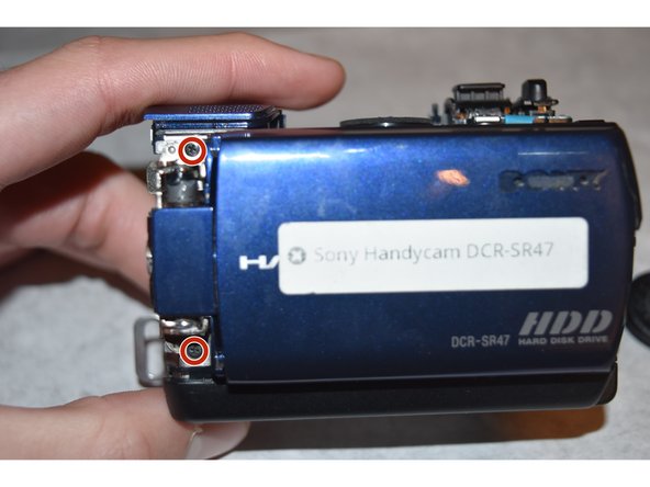

    • Using the Phillips #000 screwdriver, remove all six of the 3mm screws located on the side of the camera.
    • This step seems unnecessary to initially find the hard drive, but will allow access to the attached flex cable.

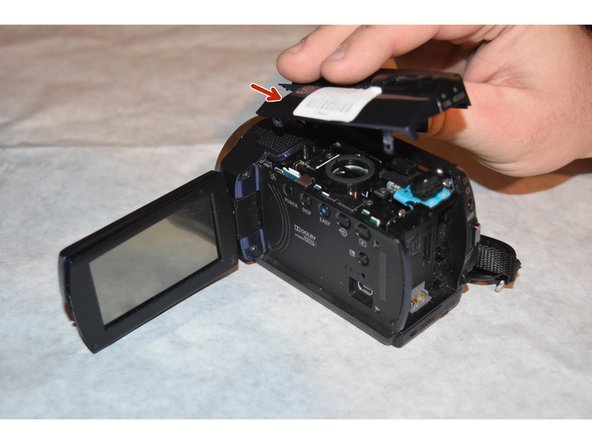

    • Using the Phillips #000 screwdriver, remove the four screws from the housing under the hard drive.
    • Remove the top plastic housing of the camera. All screws attaching the housing have previously been removed.

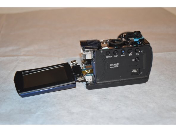

    • Using the Phillips #000 screwdriver, remove the two 3mm screws from the LCD Screen connector and the two 3mm screws on the front plate of the camera
    • Remove the two 3mm screws that were exposed through the previous image
    • Carefully detach the LCD Screen from the rest of the camera.

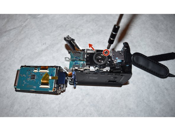

    • Carefully remove the lens covering from the camera in order to access the internal components
  9. Sony Handycam DCR-SR 47 Speaker Replacement: crwdns2935265:09crwdnd2935265:01crwdnd2935265:02crwdne2935265:0 Sony Handycam DCR-SR 47 Speaker Replacement: crwdns2935265:09crwdnd2935265:02crwdnd2935265:02crwdne2935265:0
    • Using the spudger, remove the top housing where the hard drive was located.
  10. Sony Handycam DCR-SR 47 Speaker Replacement: crwdns2935265:010crwdnd2935265:01crwdnd2935265:02crwdne2935265:0 Sony Handycam DCR-SR 47 Speaker Replacement: crwdns2935265:010crwdnd2935265:02crwdnd2935265:02crwdne2935265:0
    • Using the #000 Phillips Screwdriver, remove the one 3mm screw holding the speaker housing
    • Once the screw is removed, the speaker can be separated from the camcorder
