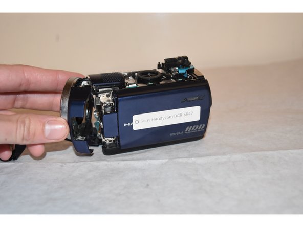

    • Remove the battery.
    • Use a Philips #000 screwdriver to remove the 3mm screw under the battery.
    • It is recommended that you wait one hour after removing the battery before disassembling the rest of the camera.
  2. Sony Handycam DCR-SR 47 LCD Screen Replacement: crwdns2935265:02crwdnd2935265:01crwdnd2935265:01crwdne2935265:0
    • Using the Phillips #000 screwdriver, remove all six of the 3mm screws located on the side of the camera.
    • This step seems unnecessary to initially find the hard drive, but will allow access to the attached flex cable.
  3. Sony Handycam DCR-SR 47 LCD Screen Replacement: crwdns2935265:03crwdnd2935265:01crwdnd2935265:01crwdne2935265:0
    • Using the Phillips #000 screwdriver remove the three 3mm screws from under the LCD screen.
  4. Sony Handycam DCR-SR 47 LCD Screen Replacement: crwdns2935265:04crwdnd2935265:01crwdnd2935265:02crwdne2935265:0 Sony Handycam DCR-SR 47 LCD Screen Replacement: crwdns2935265:04crwdnd2935265:02crwdnd2935265:02crwdne2935265:0
    • Using a Phillips #000 screwdriver remove the single 3mm screw on the back of the camera.
    • Pull away the back shell of the camera to expose the hard drive.

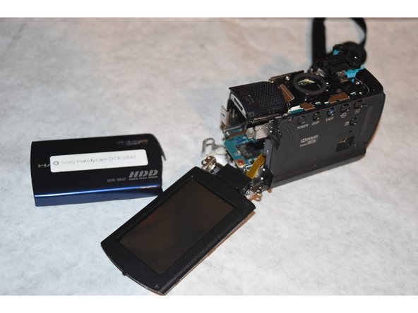

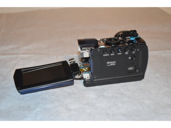

  6. Sony Handycam DCR-SR 47 LCD Screen Replacement, LCD Screen: crwdns2935265:06crwdnd2935265:01crwdnd2935265:02crwdne2935265:0 Sony Handycam DCR-SR 47 LCD Screen Replacement, LCD Screen: crwdns2935265:06crwdnd2935265:02crwdnd2935265:02crwdne2935265:0
    • Use a Philips #000 screwdriver to remove the two 3mm screws on the hinge securing the screen to the body of the camera.
  7. Sony Handycam DCR-SR 47 LCD Screen Replacement: crwdns2935265:07crwdnd2935265:01crwdnd2935265:02crwdne2935265:0 Sony Handycam DCR-SR 47 LCD Screen Replacement: crwdns2935265:07crwdnd2935265:02crwdnd2935265:02crwdne2935265:0
    • Use a Philips #000 screwdriver to remove the two 3mm screws on the opposite side of the hinge.
    • The screen is now no longer attached to the body of the camera through screws.

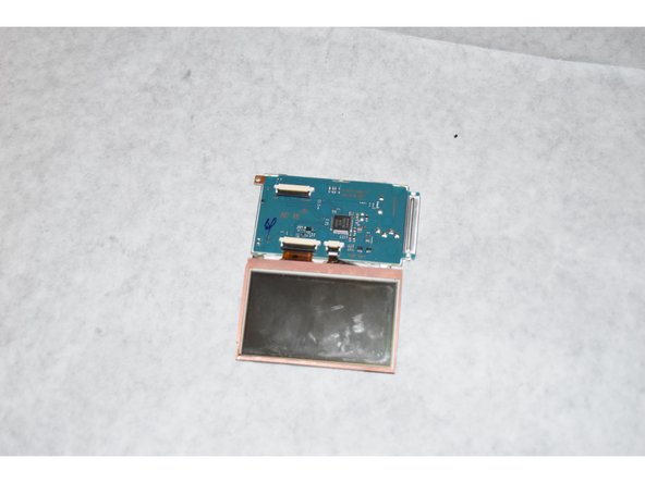

  8. Sony Handycam DCR-SR 47 LCD Screen Replacement: crwdns2935265:08crwdnd2935265:01crwdnd2935265:02crwdne2935265:0 Sony Handycam DCR-SR 47 LCD Screen Replacement: crwdns2935265:08crwdnd2935265:02crwdnd2935265:02crwdne2935265:0
    • Using the plastic opening tool, gently separate the LCD screen from its plastic housing.

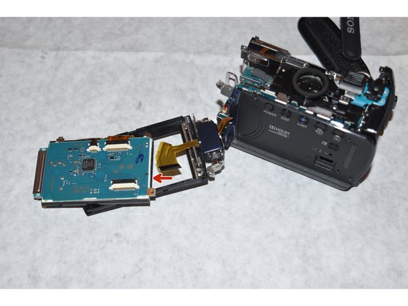

  9. Sony Handycam DCR-SR 47 LCD Screen Replacement: crwdns2935265:09crwdnd2935265:01crwdnd2935265:01crwdne2935265:0
    • Using the spudger or your fingers, gently remove the smaller end of the flex cable from the LCD Screen.
  10. Sony Handycam DCR-SR 47 LCD Screen Replacement: crwdns2935265:010crwdnd2935265:01crwdnd2935265:02crwdne2935265:0 Sony Handycam DCR-SR 47 LCD Screen Replacement: crwdns2935265:010crwdnd2935265:02crwdnd2935265:02crwdne2935265:0
    • Using the Phillips #000 screwdriver, remove the 3mm screw from the LCD screen.
    • The LCD screen may now be removed from the camera completely.
  11. Sony Handycam DCR-SR 47 LCD Screen Replacement: crwdns2935265:011crwdnd2935265:01crwdnd2935265:02crwdne2935265:0 Sony Handycam DCR-SR 47 LCD Screen Replacement: crwdns2935265:011crwdnd2935265:02crwdnd2935265:02crwdne2935265:0
    • Remove the old LCD screen and replace it with the new screen.
