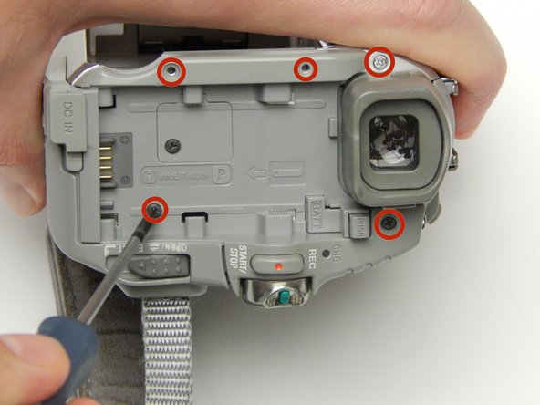

    • Face the camera with the viewfinder towards you.
    • Remove the five 5 MM Phillips #1 screws circled here.

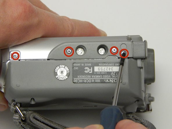

    • Flip the camera where the bottom faces toward you.
    • Remove these four circled 5 MM Phillips #1 screws.

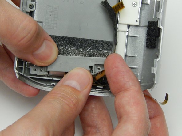

    • Remove the two 5 MM Phillips #1 screws found on the underside according to the picture.
    • Gently slip the flex cable out of its housing (indicated at the orange circle).
    • Lift the plastic covering on the hinge where the LCD screen had previously been.

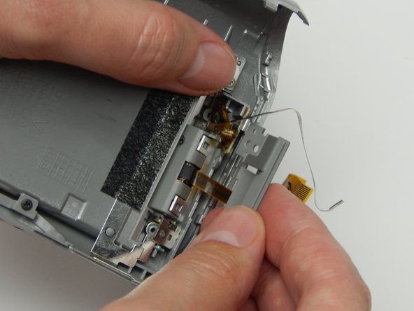

    • Flip the camera upside down and face the LCD screen side toward you.
    • Remove the flex cable assembly and thread the cable through the opening.

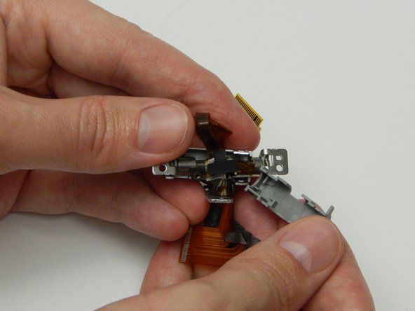

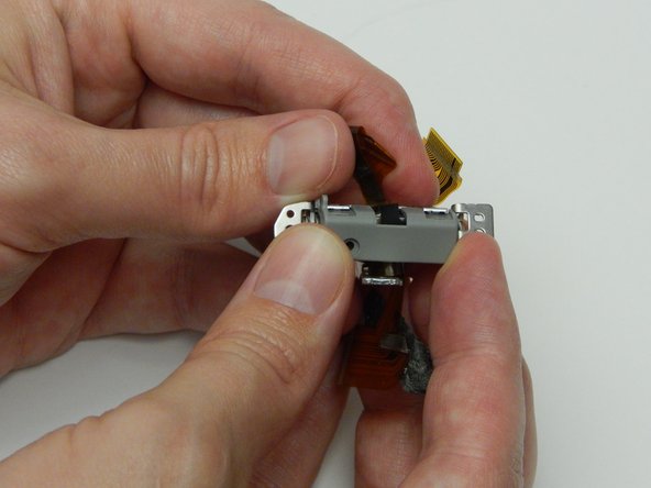

    • Using the spudger, depress the clips within the holes as shown. Make sure to flip the assembly over and do the other side as well.
    • While grasping the metal section of the assembly, remove the plastic covering that was attached with the clips.
  9. Sony Handycam DCR-HC30 Flex Cable Replacement: crwdns2935265:09crwdnd2935265:01crwdnd2935265:03crwdne2935265:0 Sony Handycam DCR-HC30 Flex Cable Replacement: crwdns2935265:09crwdnd2935265:02crwdnd2935265:03crwdne2935265:0 Sony Handycam DCR-HC30 Flex Cable Replacement: crwdns2935265:09crwdnd2935265:03crwdnd2935265:03crwdne2935265:0

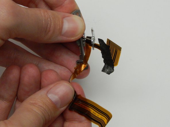

    • While grasping the metal assembly, gently unravel the flex cable.
    • The flex cable is tightly wound around a metal rod in the center of the assembly.
    • Remove the flex cable from the assembly.
