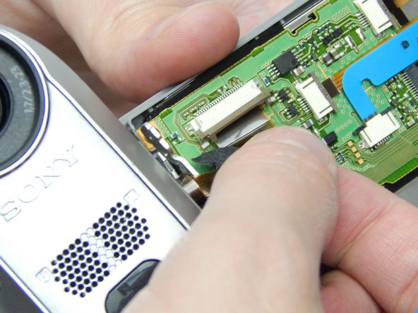

    • Using the plastic opening tool, gently lift up the holder that keeps the ribbon in place.
    • Gently slip the ribbon from its housing.

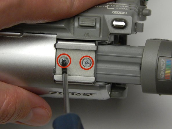

    • Remove the five 5 MM Phillips #1 screws circled here.
    • Flip the camera where the bottom faces toward you.
    • Remove the four circled 5 MM Phillips #1 screws.

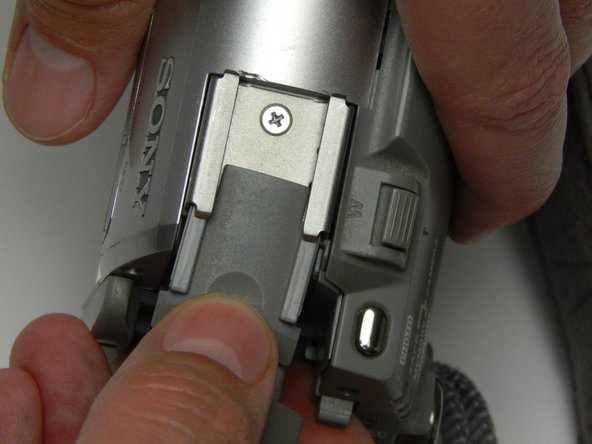

    • Remove the two 10 MM Phillips #1 screws that were under the covering.

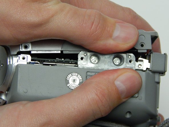

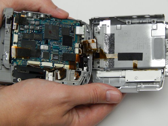

    • Remove the last 5 MM Phillips #1 screw that is somewhat hidden in the resting place of the LCD screen.
    • For the next step make sure to be careful so as to not break any of the clips that hold the camera's two halves together.
    • With the bottom of the camera facing you grasp each half of the camera and gently pull the halves apart.
    • There will be some slight popping sounds as the clips release.
  7. Sony Handycam DCR-HC30 CCD Image Sensor Replacement: crwdns2935265:07crwdnd2935265:01crwdnd2935265:03crwdne2935265:0 Sony Handycam DCR-HC30 CCD Image Sensor Replacement: crwdns2935265:07crwdnd2935265:02crwdnd2935265:03crwdne2935265:0 Sony Handycam DCR-HC30 CCD Image Sensor Replacement: crwdns2935265:07crwdnd2935265:03crwdnd2935265:03crwdne2935265:0
    • Face the camera with the strap toward you and remove the two 5 MM Phillips #1 screws indicated here.
    • Firmly grasp the silver part of the camera below the lens and pull away.
    • Be careful not to pull the ribbon from its housing.

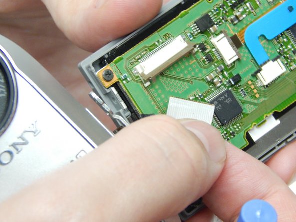

  8. Sony Handycam DCR-HC30 CCD Image Sensor Replacement: crwdns2935265:08crwdnd2935265:01crwdnd2935265:03crwdne2935265:0 Sony Handycam DCR-HC30 CCD Image Sensor Replacement: crwdns2935265:08crwdnd2935265:02crwdnd2935265:03crwdne2935265:0 Sony Handycam DCR-HC30 CCD Image Sensor Replacement: crwdns2935265:08crwdnd2935265:03crwdnd2935265:03crwdne2935265:0
    • Flip the camera on its side with the strap facing down and lay the other half as shown in the photo.

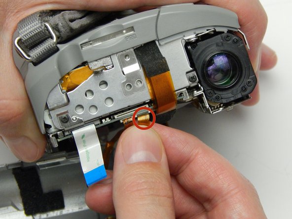

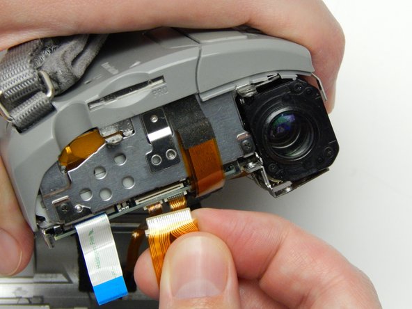

    • Using the plastic opening tool remove the ribbon from its housing.
  9. Sony Handycam DCR-HC30 CCD Image Sensor Replacement: crwdns2935265:09crwdnd2935265:01crwdnd2935265:03crwdne2935265:0 Sony Handycam DCR-HC30 CCD Image Sensor Replacement: crwdns2935265:09crwdnd2935265:02crwdnd2935265:03crwdne2935265:0 Sony Handycam DCR-HC30 CCD Image Sensor Replacement: crwdns2935265:09crwdnd2935265:03crwdnd2935265:03crwdne2935265:0
    • Face the lens of the camera toward you.
    • Gently remove the two ribbons that are keeping the other half linked to the camera.
