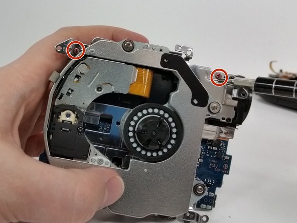

  18. Sony Handycam DCR-DVD650 Optical Assembly Replacement, Optical Assembly: crwdns2935265:018crwdnd2935265:01crwdnd2935265:03crwdne2935265:0 Sony Handycam DCR-DVD650 Optical Assembly Replacement, Optical Assembly: crwdns2935265:018crwdnd2935265:02crwdnd2935265:03crwdne2935265:0 Sony Handycam DCR-DVD650 Optical Assembly Replacement, Optical Assembly: crwdns2935265:018crwdnd2935265:03crwdnd2935265:03crwdne2935265:0
    • After the door is separated from the frame, set the door aside.
    • Remove the two bronze (2mm, Phillips #00) screws at the top of the metal frame.
    • Separate the disc reading frame from the optical housing frame and set the disc reading frame aside.

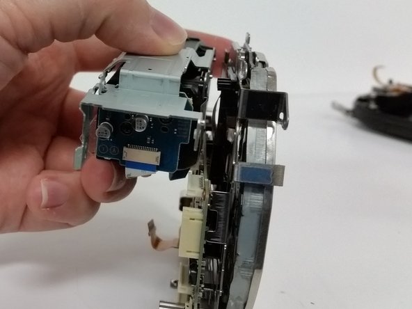

  19. Sony Handycam DCR-DVD650 Optical Assembly Replacement: crwdns2935265:019crwdnd2935265:01crwdnd2935265:03crwdne2935265:0 Sony Handycam DCR-DVD650 Optical Assembly Replacement: crwdns2935265:019crwdnd2935265:02crwdnd2935265:03crwdne2935265:0 Sony Handycam DCR-DVD650 Optical Assembly Replacement: crwdns2935265:019crwdnd2935265:03crwdnd2935265:03crwdne2935265:0
    • Unscrew the top two screws (5mm, Phillips #00) on the frame of the optical assembly.
    • Remove the frame from the optical assembly.

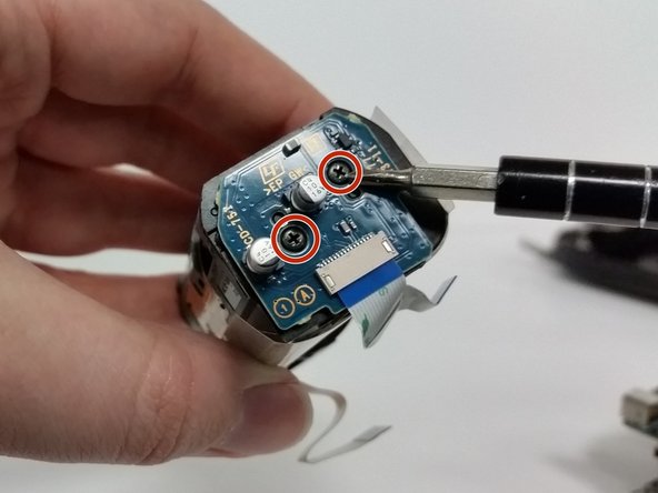

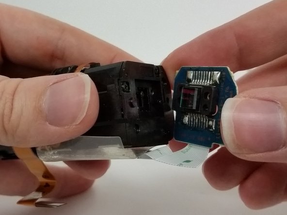

  20. Sony Handycam DCR-DVD650 Optical Assembly Replacement: crwdns2935265:020crwdnd2935265:01crwdnd2935265:03crwdne2935265:0 Sony Handycam DCR-DVD650 Optical Assembly Replacement: crwdns2935265:020crwdnd2935265:02crwdnd2935265:03crwdne2935265:0 Sony Handycam DCR-DVD650 Optical Assembly Replacement: crwdns2935265:020crwdnd2935265:03crwdnd2935265:03crwdne2935265:0
    • You've reached the optical assembly.
    • Depending on the part you've received to replace the optical assembly, you may need to remove the circuit panel on the back of the assembly.
    • Unscrew the two screws (5mm, Phillips #00) from the circuit board and separate the board from the assembly.
