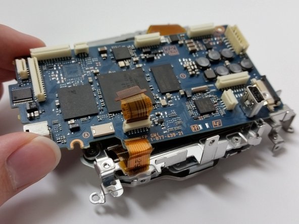

  10. Sony Handycam DCR-DVD650 Motherboard Replacement: crwdns2935265:010crwdnd2935265:01crwdnd2935265:03crwdne2935265:0 Sony Handycam DCR-DVD650 Motherboard Replacement: crwdns2935265:010crwdnd2935265:02crwdnd2935265:03crwdne2935265:0 Sony Handycam DCR-DVD650 Motherboard Replacement: crwdns2935265:010crwdnd2935265:03crwdnd2935265:03crwdne2935265:0
    • Locate all of the cables attached to the motherboard.
    • Carefully disconnect all cables.
    • There are four orange no-fuss ribbon connectors. To disconnect these cables pull up on the tabs protruding from both sides of the cable rather than pulling on the cable itself.
    • There are two white no-fuss ribbon cable connectors. To disconnect these cables, pull them straight out of the connector.
    • In the lower corner on the far right, disconnect the Zero-Insertion Force (ZIF) connector by flipping up the small black bar before removing the cable.
    • Power Cable: Disconnect the bundled cable connector by prying up gently from the edges. If you need to, collect the cables between you fingers and pull gently to remove. Try not to pull more on one wire than the rest as this can strain and separate the wires.

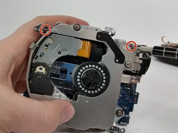

  13. Sony Handycam DCR-DVD650 Motherboard Replacement: crwdns2935265:013crwdnd2935265:01crwdnd2935265:03crwdne2935265:0 Sony Handycam DCR-DVD650 Motherboard Replacement: crwdns2935265:013crwdnd2935265:02crwdnd2935265:03crwdne2935265:0 Sony Handycam DCR-DVD650 Motherboard Replacement: crwdns2935265:013crwdnd2935265:03crwdnd2935265:03crwdne2935265:0
    • Remove the bronze screw (2 mm, Phillips #00) attaching the rear housing to the frame.
    • If you are using a screwdriver that uses interchangeable tips, the connecting base of the screwdriver is too wide for reaching this screw. You will need to use a standard (and magnetic, if possible) Phillips #00 screwdriver.
    • Once the screw is removed, the rear housing can be gently pulled away.

  15. Sony Handycam DCR-DVD650 Motherboard Replacement: crwdns2935265:015crwdnd2935265:01crwdnd2935265:03crwdne2935265:0 Sony Handycam DCR-DVD650 Motherboard Replacement: crwdns2935265:015crwdnd2935265:02crwdnd2935265:03crwdne2935265:0 Sony Handycam DCR-DVD650 Motherboard Replacement: crwdns2935265:015crwdnd2935265:03crwdnd2935265:03crwdne2935265:0
    • Remove the three black screws (5 mm, Phillips #00) connecting the frame to the disc housing.
  16. Sony Handycam DCR-DVD650 Motherboard Replacement: crwdns2935265:016crwdnd2935265:01crwdnd2935265:01crwdne2935265:0
    • Remove the motherboard and frame and set aside.
    • If your replacement part includes the full disc door assembly, you can stop here and reassemble your device.

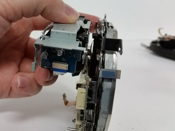

  18. Sony Handycam DCR-DVD650 Motherboard Replacement, Motherboard: crwdns2935265:018crwdnd2935265:01crwdnd2935265:03crwdne2935265:0 Sony Handycam DCR-DVD650 Motherboard Replacement, Motherboard: crwdns2935265:018crwdnd2935265:02crwdnd2935265:03crwdne2935265:0 Sony Handycam DCR-DVD650 Motherboard Replacement, Motherboard: crwdns2935265:018crwdnd2935265:03crwdnd2935265:03crwdne2935265:0
    • After the disc door is separated from the frame, set aside.
    • Remove the two bronze screws (2mm, Phillips #00) at the top of the metal frame.
    • Separate the disc reading frame from the optical housing frame and set the optical housing aside.
  19. Sony Handycam DCR-DVD650 Motherboard Replacement: crwdns2935265:019crwdnd2935265:01crwdnd2935265:02crwdne2935265:0 Sony Handycam DCR-DVD650 Motherboard Replacement: crwdns2935265:019crwdnd2935265:02crwdnd2935265:02crwdne2935265:0
    • Locate and remove the three bronze screws (2mm, Phillips #00) attached to the motherboard.
    • Shift the board up carefully away from the rest of the assembly.
    • Do not pull the motherboard away abruptly. A ribbon cable is attached on the back.

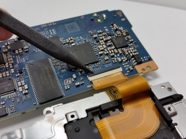

  20. Sony Handycam DCR-DVD650 Motherboard Replacement: crwdns2935265:020crwdnd2935265:01crwdnd2935265:02crwdne2935265:0 Sony Handycam DCR-DVD650 Motherboard Replacement: crwdns2935265:020crwdnd2935265:02crwdnd2935265:02crwdne2935265:0
    • Locate where the ribbon cable is attached on the back of the motherboard.
    • Use a spudger or small pry tool to lift the black flap on the zero insertion force (ZIF) connector which secures the ribbon.
    • Gently remove ribbon and replace motherboard.
