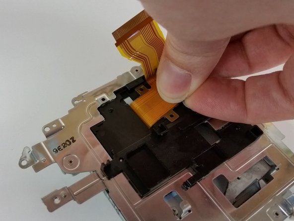

  20. Sony Handycam DCR-DVD650 Laser Assembly Replacement: crwdns2935265:020crwdnd2935265:01crwdnd2935265:02crwdne2935265:0 Sony Handycam DCR-DVD650 Laser Assembly Replacement: crwdns2935265:020crwdnd2935265:02crwdnd2935265:02crwdne2935265:0
    • Locate where the ribbon cable is attached on the back of the motherboard.
    • Use a spudger or small pry tool to lift the black flap on the zero insertion force (ZIF) connector which secures the ribbon.
    • Gently remove ribbon and replace motherboard.

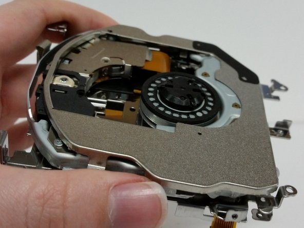

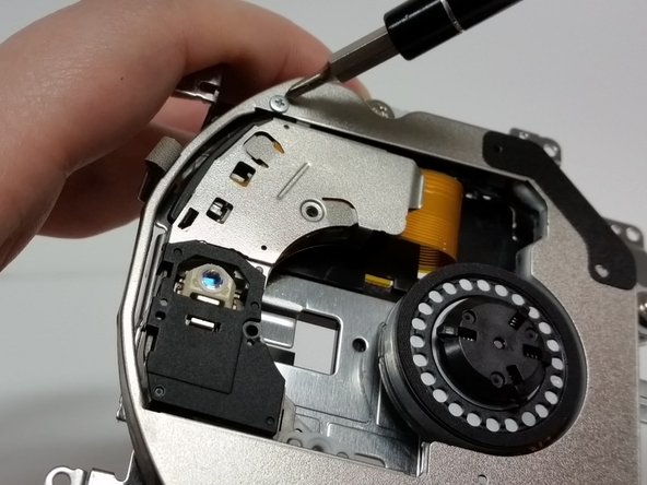

  21. Sony Handycam DCR-DVD650 Laser Assembly Replacement, Laser Assembly: crwdns2935265:021crwdnd2935265:01crwdnd2935265:03crwdne2935265:0 Sony Handycam DCR-DVD650 Laser Assembly Replacement, Laser Assembly: crwdns2935265:021crwdnd2935265:02crwdnd2935265:03crwdne2935265:0 Sony Handycam DCR-DVD650 Laser Assembly Replacement, Laser Assembly: crwdns2935265:021crwdnd2935265:03crwdnd2935265:03crwdne2935265:0
    • Locate and remove the three small, silver screws (2mm, Phillips #00) attaching the cover plate.
    • Remove the cover plate by tugging up slightly and to the right.

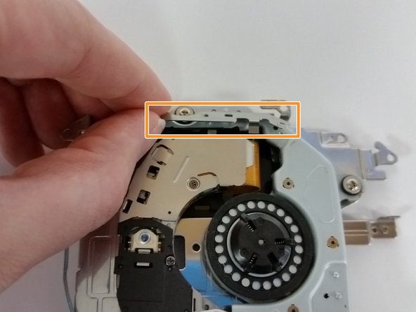

  22. Sony Handycam DCR-DVD650 Laser Assembly Replacement: crwdns2935265:022crwdnd2935265:01crwdnd2935265:03crwdne2935265:0 Sony Handycam DCR-DVD650 Laser Assembly Replacement: crwdns2935265:022crwdnd2935265:02crwdnd2935265:03crwdne2935265:0 Sony Handycam DCR-DVD650 Laser Assembly Replacement: crwdns2935265:022crwdnd2935265:03crwdnd2935265:03crwdne2935265:0
    • Remove the screws (2mm, Phillips #00) that hold the lens assembly in place.
    • Pull up the cover plates that have just been unscrewed.
    • The top bar hold in place a small, black sliding rail. This will fall out once the cover plate is removed. Set aside with the cover plate and screws and make sure to mark the parts.
    • The bottom outer screws, hold a silver sliding rail in place, which will come undone once the plates and screws are removed. Again, set aside the cover plates and screws, making sure to mark the parts.

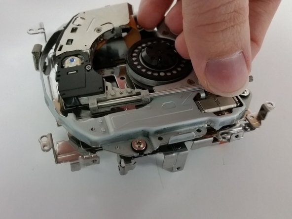

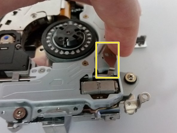

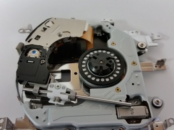

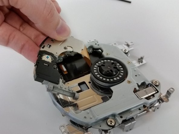

  23. Sony Handycam DCR-DVD650 Laser Assembly Replacement: crwdns2935265:023crwdnd2935265:01crwdnd2935265:02crwdne2935265:0 Sony Handycam DCR-DVD650 Laser Assembly Replacement: crwdns2935265:023crwdnd2935265:02crwdnd2935265:02crwdne2935265:0
    • With the slider's cover plates removed, shift the laser assembly up slightly and out to the left.
  24. Sony Handycam DCR-DVD650 Laser Assembly Replacement: crwdns2935265:024crwdnd2935265:01crwdnd2935265:03crwdne2935265:0 Sony Handycam DCR-DVD650 Laser Assembly Replacement: crwdns2935265:024crwdnd2935265:02crwdnd2935265:03crwdne2935265:0 Sony Handycam DCR-DVD650 Laser Assembly Replacement: crwdns2935265:024crwdnd2935265:03crwdnd2935265:03crwdne2935265:0
    • Unscrew the screw (2mm, Phillips #00) from the white, plastic piece on the silver sliding rod and set aside.
    • Slide out the silver sliding rod.
    • The optical assembly is almost ready to be removed.

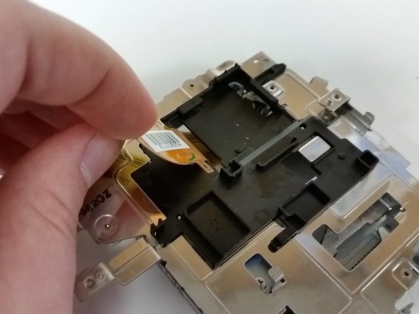

  25. Sony Handycam DCR-DVD650 Laser Assembly Replacement: crwdns2935265:025crwdnd2935265:01crwdnd2935265:03crwdne2935265:0 Sony Handycam DCR-DVD650 Laser Assembly Replacement: crwdns2935265:025crwdnd2935265:02crwdnd2935265:03crwdne2935265:0 Sony Handycam DCR-DVD650 Laser Assembly Replacement: crwdns2935265:025crwdnd2935265:03crwdnd2935265:03crwdne2935265:0
    • Gently turn the device over.
    • Carefully pry up the ribbon cable.
    • It may be helpful to work from the lower right corner where the ribbon curves.

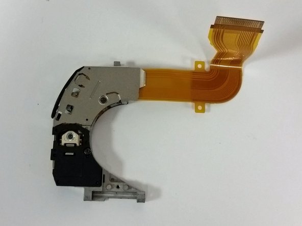

  26. Sony Handycam DCR-DVD650 Laser Assembly Replacement: crwdns2935265:026crwdnd2935265:01crwdnd2935265:02crwdne2935265:0 Sony Handycam DCR-DVD650 Laser Assembly Replacement: crwdns2935265:026crwdnd2935265:02crwdnd2935265:02crwdne2935265:0
    • Turn the device over again.
    • Unthread the ribbon cable.
    • The lens assembly is separated from the device.
