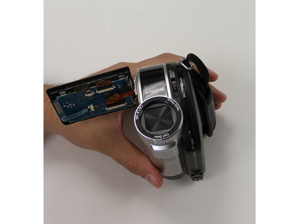

    • Remove the first screw located on the bottom of the LCD screen by using a cross tip screwdriver.
  2. Sony Handycam DCR-DVD650 LCD Touchscreen  Replacement: crwdns2935265:02crwdnd2935265:01crwdnd2935265:01crwdne2935265:0
    • Turn the LCD screen either clockwise or counterclockwise for a better view of the screw.
    • Remove the second screw.
  3. Sony Handycam DCR-DVD650 LCD Touchscreen  Replacement: crwdns2935265:03crwdnd2935265:01crwdnd2935265:02crwdne2935265:0 Sony Handycam DCR-DVD650 LCD Touchscreen  Replacement: crwdns2935265:03crwdnd2935265:02crwdnd2935265:02crwdne2935265:0
    • Place a plastic opening tool along the outside of the touchscreen.
    • Follow the path to remove the panel.

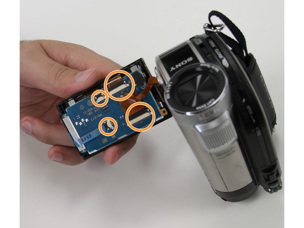

  4. Sony Handycam DCR-DVD650 LCD Touchscreen  Replacement: crwdns2935265:04crwdnd2935265:01crwdnd2935265:02crwdne2935265:0 Sony Handycam DCR-DVD650 LCD Touchscreen  Replacement: crwdns2935265:04crwdnd2935265:02crwdnd2935265:02crwdne2935265:0
    • Remove each of the ribbon cables off by lifting up on the black tab.
    • Remove all ribbon cables before continuing unto the next step.

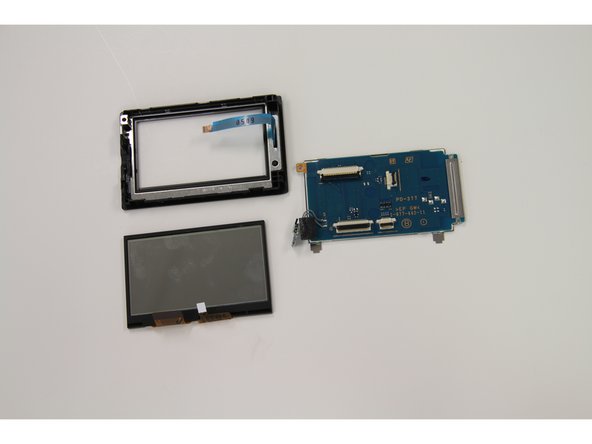

    • Unscrew the final screw located on the top left corner.
    • Remove the screen.
