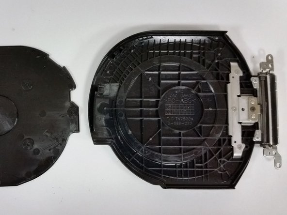

  17. Sony Handycam DCR-DVD650 Door Hinge Replacement: crwdns2935265:017crwdnd2935265:01crwdnd2935265:03crwdne2935265:0 Sony Handycam DCR-DVD650 Door Hinge Replacement: crwdns2935265:017crwdnd2935265:02crwdnd2935265:03crwdne2935265:0 Sony Handycam DCR-DVD650 Door Hinge Replacement: crwdns2935265:017crwdnd2935265:03crwdnd2935265:03crwdne2935265:0
    • Remove the two outer screws (4mm, Phillips #00) from the hinge.
    • Opening the door to a full 90 degrees, should allow the door to be tugged up and out from the disc door frame.

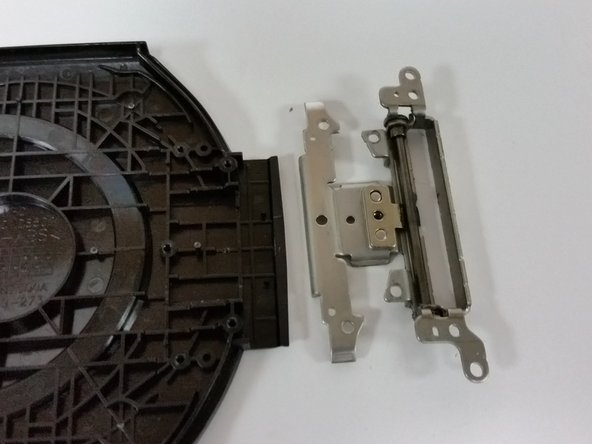

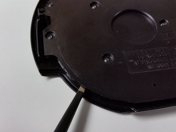

  18. Sony Handycam DCR-DVD650 Door Hinge Replacement, Door Hinge: crwdns2935265:018crwdnd2935265:01crwdnd2935265:03crwdne2935265:0 Sony Handycam DCR-DVD650 Door Hinge Replacement, Door Hinge: crwdns2935265:018crwdnd2935265:02crwdnd2935265:03crwdne2935265:0 Sony Handycam DCR-DVD650 Door Hinge Replacement, Door Hinge: crwdns2935265:018crwdnd2935265:03crwdnd2935265:03crwdne2935265:0
    • Once the door is detached, the plastic panel on the inside of the door will need to be removed.
    • Proceed with caution when prying up the plastic panel. With the way the device is assembled, the panel may not snap back into place once removed.
    • Use a spudger, pry tool, or tweezers to separate the panel from the outer door.

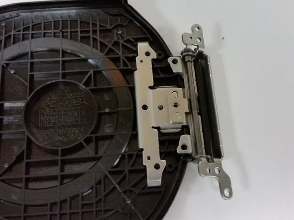

  19. Sony Handycam DCR-DVD650 Door Hinge Replacement: crwdns2935265:019crwdnd2935265:01crwdnd2935265:03crwdne2935265:0 Sony Handycam DCR-DVD650 Door Hinge Replacement: crwdns2935265:019crwdnd2935265:02crwdnd2935265:03crwdne2935265:0 Sony Handycam DCR-DVD650 Door Hinge Replacement: crwdns2935265:019crwdnd2935265:03crwdnd2935265:03crwdne2935265:0
    • Locate and remove the screws (2 silver 4mm - right top/bottom, 1 black 4mm - right center, and 3 silver 3mm -left, Phillips #00).
    • Remove the hinge from the door.
