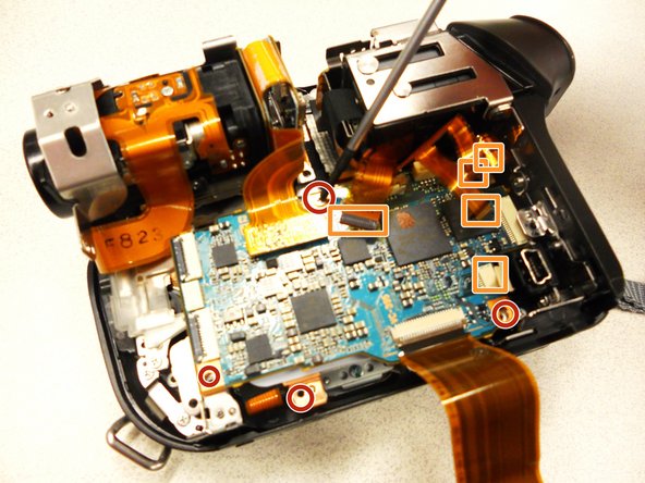

  12. Sony Handycam DCR-DVD103 Lens Replacement: crwdns2935265:012crwdnd2935265:01crwdnd2935265:01crwdne2935265:0
    • Gently slide the ribbon cables away from their connections on the motherboard.
    • Caution: Too much force will tear the cables.

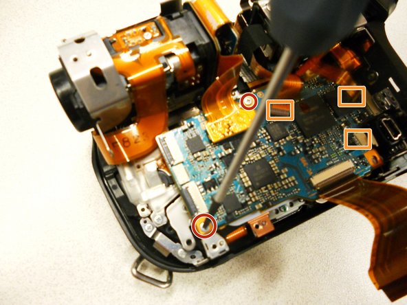

  14. Sony Handycam DCR-DVD103 Lens Replacement: crwdns2935265:014crwdnd2935265:01crwdnd2935265:03crwdne2935265:0 Sony Handycam DCR-DVD103 Lens Replacement: crwdns2935265:014crwdnd2935265:02crwdnd2935265:03crwdne2935265:0 Sony Handycam DCR-DVD103 Lens Replacement: crwdns2935265:014crwdnd2935265:03crwdnd2935265:03crwdne2935265:0
    • Remove the five 2.9 mm screws connected to the circuit board.
    • Remove the circuit board from the camera.
    • Remove the five copper wires attached to the circuit board.

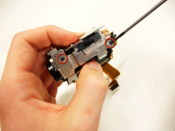

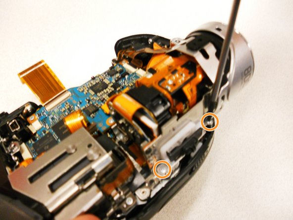

    • Unscrew the three 2.9 mm black screws to remove the metal bracket from the lens.
  16. Sony Handycam DCR-DVD103 Lens Replacement: crwdns2935265:016crwdnd2935265:01crwdnd2935265:02crwdne2935265:0 Sony Handycam DCR-DVD103 Lens Replacement: crwdns2935265:016crwdnd2935265:02crwdnd2935265:02crwdne2935265:0
    • Remove the two silver 4.5 mm screws from the bottom of the lens.
    • Caution: Be careful with the lens once the screws are removed. The lens contains a small piece of glass that can fall out.
