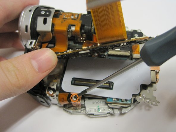

  13. Sony Handycam DCR-DVD103 Laser Disc Replacement: crwdns2935265:013crwdnd2935265:01crwdnd2935265:03crwdne2935265:0 Sony Handycam DCR-DVD103 Laser Disc Replacement: crwdns2935265:013crwdnd2935265:02crwdnd2935265:03crwdne2935265:0 Sony Handycam DCR-DVD103 Laser Disc Replacement: crwdns2935265:013crwdnd2935265:03crwdnd2935265:03crwdne2935265:0
    • Unplug copper strip and lift up.
    • Pull off tape over 2.3mm screw.
    • Remove (1) 2.3mm screw from under the tape.

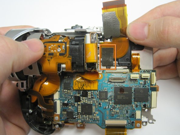

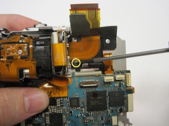

  14. Sony Handycam DCR-DVD103 Laser Disc Replacement: crwdns2935265:014crwdnd2935265:01crwdnd2935265:02crwdne2935265:0 Sony Handycam DCR-DVD103 Laser Disc Replacement: crwdns2935265:014crwdnd2935265:02crwdnd2935265:02crwdne2935265:0
    • Pull the copper strip, marked by the red rectangle, through the hole behind it, marked with the yellow rectangle.

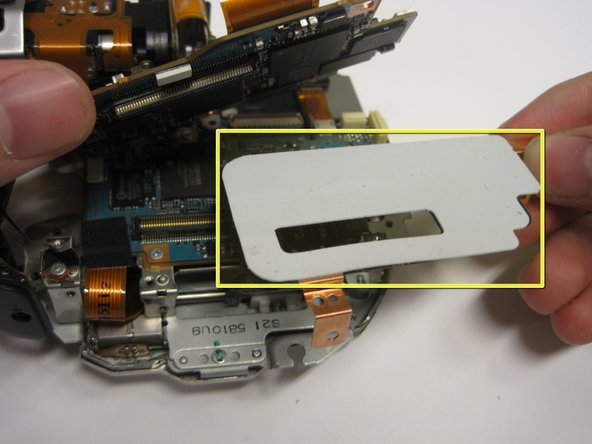

  15. Sony Handycam DCR-DVD103 Laser Disc Replacement: crwdns2935265:015crwdnd2935265:01crwdnd2935265:03crwdne2935265:0 Sony Handycam DCR-DVD103 Laser Disc Replacement: crwdns2935265:015crwdnd2935265:02crwdnd2935265:03crwdne2935265:0 Sony Handycam DCR-DVD103 Laser Disc Replacement: crwdns2935265:015crwdnd2935265:03crwdnd2935265:03crwdne2935265:0
    • Remove (3) 2.9mm screws from top circuit board.
    • Note: Circuit board will resist trying to be pulled off so pull it off with care but still firmly.
    • Lift up circuit board and remove (1) 2.9mm screw underneath.
    • Pull out copper plate with rubber insulator on it.

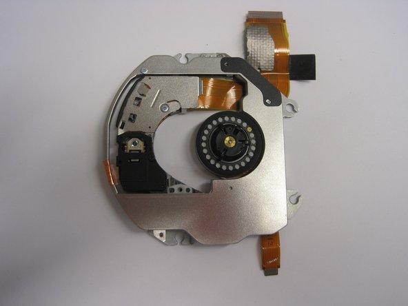

  16. Sony Handycam DCR-DVD103 Laser Disc Replacement: crwdns2935265:016crwdnd2935265:01crwdnd2935265:03crwdne2935265:0 Sony Handycam DCR-DVD103 Laser Disc Replacement: crwdns2935265:016crwdnd2935265:02crwdnd2935265:03crwdne2935265:0 Sony Handycam DCR-DVD103 Laser Disc Replacement: crwdns2935265:016crwdnd2935265:03crwdnd2935265:03crwdne2935265:0
    • Remove tape over copper strip in the bottom left corner and pull out copper strip.
    • Remove laser reader assembly.
