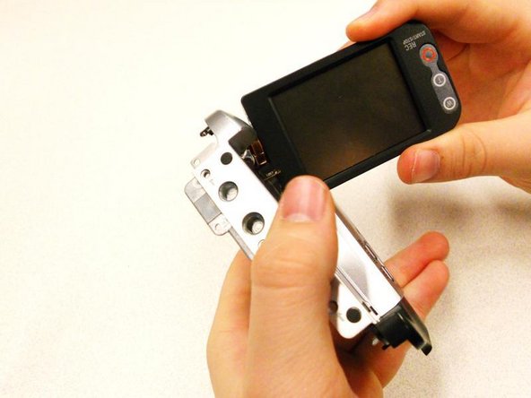

  9. Sony Handycam DCR-DVD103 LCD Screen Replacement: crwdns2935265:09crwdnd2935265:01crwdnd2935265:01crwdne2935265:0
    • Gently pull apart the outer silver case and screen.
    • Remove the copper wire strip to detach the case from the camera.
  10. Sony Handycam DCR-DVD103 LCD Screen Replacement, LCD Screen: crwdns2935265:010crwdnd2935265:01crwdnd2935265:01crwdne2935265:0
    • Remove the copper strip from the housing that connects the outer casing to the entire of the camera.
    • Use caution when removing the wire, too much force may cause it to tear.

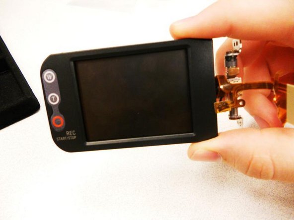

  14. Sony Handycam DCR-DVD103 LCD Screen Replacement: crwdns2935265:014crwdnd2935265:01crwdnd2935265:01crwdne2935265:0
    • Remove the silver and black, front and back casings from the base of the screen.
    • Remove one copper strip from the inside of the bottom case.
  15. Sony Handycam DCR-DVD103 LCD Screen Replacement: crwdns2935265:015crwdnd2935265:01crwdnd2935265:01crwdne2935265:0
    • Remove (2) 5.4mm screws that are securing the screen to the cover, from the base of the LCD.
  16. Sony Handycam DCR-DVD103 LCD Screen Replacement: crwdns2935265:016crwdnd2935265:01crwdnd2935265:03crwdne2935265:0 Sony Handycam DCR-DVD103 LCD Screen Replacement: crwdns2935265:016crwdnd2935265:02crwdnd2935265:03crwdne2935265:0 Sony Handycam DCR-DVD103 LCD Screen Replacement: crwdns2935265:016crwdnd2935265:03crwdnd2935265:03crwdne2935265:0
    • Twist out the screen from the cover.
    • Be careful not to break the casing when trying to get the screen out, as it does require some maneuvering.

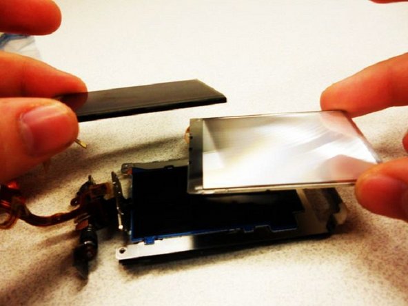

  19. Sony Handycam DCR-DVD103 LCD Screen Replacement: crwdns2935265:019crwdnd2935265:01crwdnd2935265:02crwdne2935265:0 Sony Handycam DCR-DVD103 LCD Screen Replacement: crwdns2935265:019crwdnd2935265:02crwdnd2935265:02crwdne2935265:0
    • Pull off the silver cover on the screen, which will reveal the circuit board from behind the screen itself.
    • Pull off the black tape stuck to both sides of the circuit board.

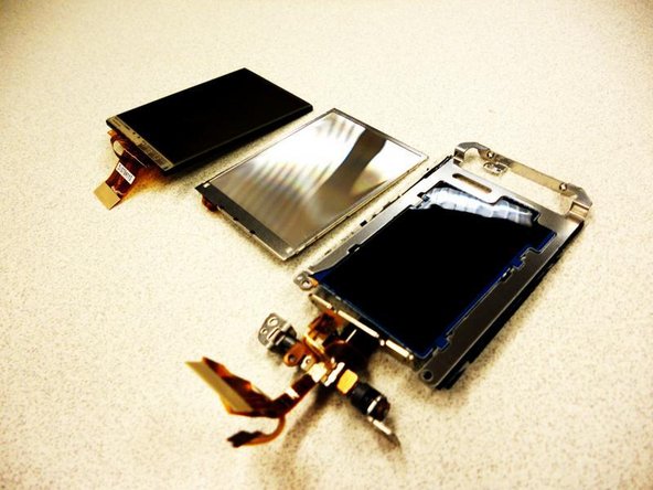

  20. Sony Handycam DCR-DVD103 LCD Screen Replacement: crwdns2935265:020crwdnd2935265:01crwdnd2935265:01crwdne2935265:0
    • Remove (3) 4.5mm screws from back-side of the LCD.
  21. Sony Handycam DCR-DVD103 LCD Screen Replacement: crwdns2935265:021crwdnd2935265:01crwdnd2935265:03crwdne2935265:0 Sony Handycam DCR-DVD103 LCD Screen Replacement: crwdns2935265:021crwdnd2935265:02crwdnd2935265:03crwdne2935265:0 Sony Handycam DCR-DVD103 LCD Screen Replacement: crwdns2935265:021crwdnd2935265:03crwdnd2935265:03crwdne2935265:0
    • Remove the (3) copper strips to remove both the screen and the back light.
    • Replace what is broken.
