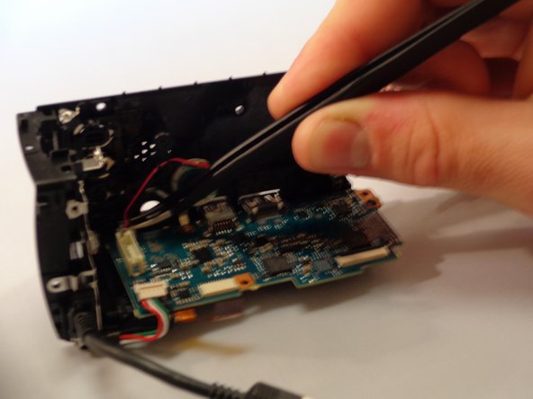

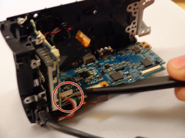

  17. Sony Handycam CX260V Internal Speaker Replacement, Internal Speaker: crwdns2935265:017crwdnd2935265:01crwdnd2935265:01crwdne2935265:0
    • Using the screwdriver remove the two black 5mm screws located on the side of the speaker.
  18. Sony Handycam CX260V Internal Speaker Replacement: crwdns2935265:018crwdnd2935265:01crwdnd2935265:03crwdne2935265:0 Sony Handycam CX260V Internal Speaker Replacement: crwdns2935265:018crwdnd2935265:02crwdnd2935265:03crwdne2935265:0 Sony Handycam CX260V Internal Speaker Replacement: crwdns2935265:018crwdnd2935265:03crwdnd2935265:03crwdne2935265:0

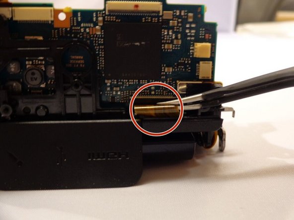

    • Gently remove the red and black wire connected to the mother board with the tweasers.
    • Remove the tri color wires from the mother board. (Has a white connection)
    • Unplug the orange flat wire located at the bottom of the camera.
    • Removes the Internal Speaker

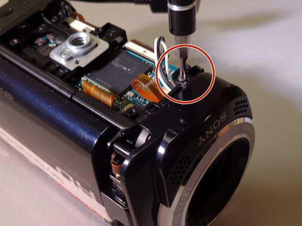

  19. Sony Handycam CX260V Internal Speaker Replacement: crwdns2935265:019crwdnd2935265:01crwdnd2935265:02crwdne2935265:0 Sony Handycam CX260V Internal Speaker Replacement: crwdns2935265:019crwdnd2935265:02crwdnd2935265:02crwdne2935265:0
    • Using a screwdriver remove 5mm silver screw located in the inner back by the battery component holding down a chip.
    • Removes the Microphone Jack
    • Using the tweezers, remove internal speaker.
