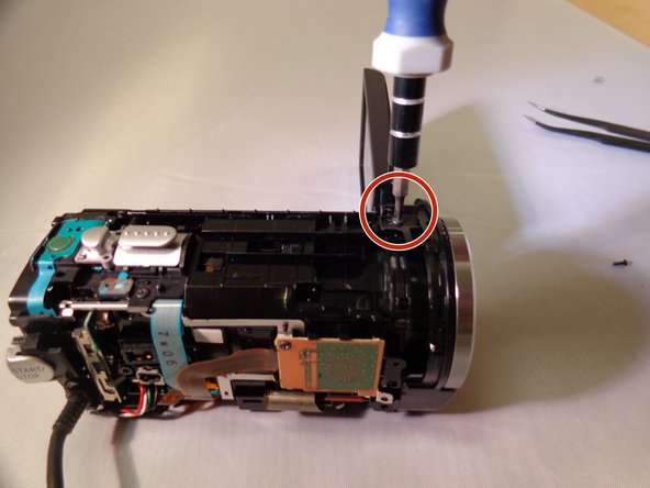

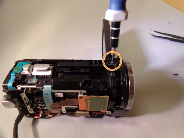

  17. Sony Handycam CX260V Camera Lens Replacement, Camera Lens: crwdns2935265:017crwdnd2935265:01crwdnd2935265:02crwdne2935265:0 Sony Handycam CX260V Camera Lens Replacement, Camera Lens: crwdns2935265:017crwdnd2935265:02crwdnd2935265:02crwdne2935265:0
    • Using the PH #00 size screw driver, unscrew one 5 millimeter screw located on the top left near the lens of the camera.
