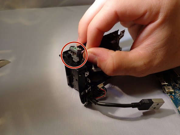

  17. Sony Handycam CX260V Battery Port Replacement, Battery Port: crwdns2935265:017crwdnd2935265:01crwdnd2935265:02crwdne2935265:0 Sony Handycam CX260V Battery Port Replacement, Battery Port: crwdns2935265:017crwdnd2935265:02crwdnd2935265:02crwdne2935265:0
    • Unplug the battery port connected to the frame/motherboard. Remove the battery port.
