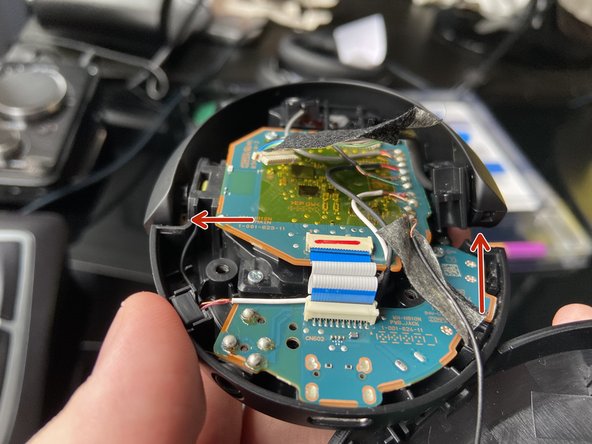

  10. Sony H.ear on 3 Headband replacement, Unstick the NFC Antenna cable: crwdns2935265:012crwdnd2935265:01crwdnd2935265:03crwdne2935265:0 Sony H.ear on 3 Headband replacement, Unstick the NFC Antenna cable: crwdns2935265:012crwdnd2935265:02crwdnd2935265:03crwdne2935265:0 Sony H.ear on 3 Headband replacement, Unstick the NFC Antenna cable: crwdns2935265:012crwdnd2935265:03crwdnd2935265:03crwdne2935265:0
    • Gently lift the cup away and peek inside without fully removing it. You should see the following:
    • A thin layer of tape holding a cable going from the boards to the NFC antenna in the outer shell piece.
    • In this picture it's already unstuck.
    • Another thin layer of tape below it holding the headband cable and NC microphone cables to the mainboard.
    • Gently pry the layer of tape holding the NFC cable.
    • This area has three layers of tape on top of the circuit board - make sure you're only unsticking the top layer that is holding the NFC cable for now.
    • Once you've done that, it should have enough slack, and then you can open it like a book from the right side.
    • You cannot disconnect the NFC antenna cable unless you have a soldering iron. Be careful if you are doing any further disassembly to the Left Speaker.
    • With one hand holding the cup and the face plate with the NFC antenna, gently lift the foam tape holding the headband cable onto the circuit board below.
    • Just peel at the area it connects to the circuit board for now.
  11. Sony H.ear on 3 Headband replacement, Disconnect the headband cable from the mainboard: crwdns2935265:014crwdnd2935265:01crwdnd2935265:01crwdne2935265:0
    • Using the pointed end of a spudger, gently pull at the edges of the sliding connector of the headband cable to disconnect it from the mainboard.
    • Gently peel the the whole headband cable up with the tape starting from the connector.
    • There are soldered NC microphone cables directly below the headband cable that may also be stuck to the tape. Be very gentle during this process, making sure you gently unstick the tape from these cables as you peel the headband cable away.
    • There's also yellow tape on the circuit board protecting chips on the mainboard from interference. Also avoid peeling this up.

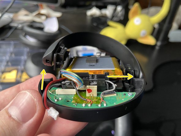

  12. Sony H.ear on 3 Headband replacement, Unscrew the rear hinge of the Left Speaker: crwdns2935265:015crwdnd2935265:01crwdnd2935265:01crwdne2935265:0
    • There are two parts of the headband hinge:
    • Rear-facing hinge held by 2 6mm JIS #000 screws
    • Front-facing hinge attached by a pivot that is socketed in the speaker casing.
    • Unscrew the 6mm screws holding the rear hinge to the speaker casing.
  13. Sony H.ear on 3 Headband replacement, Tilt and push the Left Speaker hinge: crwdns2935265:016crwdnd2935265:01crwdnd2935265:02crwdne2935265:0 Sony H.ear on 3 Headband replacement, Tilt and push the Left Speaker hinge: crwdns2935265:016crwdnd2935265:02crwdnd2935265:02crwdne2935265:0
    • On the rear hinge, gently lift up the hinge as much as is comfortable while at the same time, gently tugging on the front hinge outwards. You should be able to create a small shift in where the hinge is sitting, which is important for the next part.
    • Make sure the rear hinge bracket doesn't sit on top of the mainboard at this stage as it might press against and damage solder joints.
  14. Sony H.ear on 3 Headband replacement, Unsocket the front hinge of the Left Speaker: crwdns2935265:017crwdnd2935265:01crwdnd2935265:02crwdne2935265:0 Sony H.ear on 3 Headband replacement, Unsocket the front hinge of the Left Speaker: crwdns2935265:017crwdnd2935265:02crwdnd2935265:02crwdne2935265:0
    • If you can't desolder the NFC antenna, try to hold or rest it while you do this to avoid straining the cable.
    • Gently lift up the unscrewed rear hinge as much as is comfortable over the internals.
    • Using the extra slack from lifting the rear hinge, carefully pry out the socket of the front hinge out of the speaker casing with the flat end of a spudger.
    • When you see a yellow ring appear in an opening on the top of the hinge, you're almost there.
    • Once the socket is out, gently lift the whole headband arch away from the speaker.

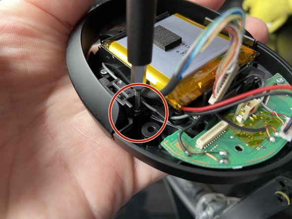

  16. Sony H.ear on 3 Headband replacement, Unscrew the rear hinge of the Right Speaker: crwdns2935265:019crwdnd2935265:01crwdnd2935265:02crwdne2935265:0 Sony H.ear on 3 Headband replacement, Unscrew the rear hinge of the Right Speaker: crwdns2935265:019crwdnd2935265:02crwdnd2935265:02crwdne2935265:0
    • The way the headband is connected to the Right speaker is exactly the same as the Left Speaker but mirrored:
  17. Sony H.ear on 3 Headband replacement, Tilt and push the Right Speaker hinge: crwdns2935265:020crwdnd2935265:01crwdnd2935265:02crwdne2935265:0 Sony H.ear on 3 Headband replacement, Tilt and push the Right Speaker hinge: crwdns2935265:020crwdnd2935265:02crwdnd2935265:02crwdne2935265:0
    • You should be able to create a small shift in where the hinge is sitting, which is important for the next part.
  18. Sony H.ear on 3 Headband replacement, Unsocket the front hinge of the Right Speaker: crwdns2935265:021crwdnd2935265:01crwdnd2935265:03crwdne2935265:0 Sony H.ear on 3 Headband replacement, Unsocket the front hinge of the Right Speaker: crwdns2935265:021crwdnd2935265:02crwdnd2935265:03crwdne2935265:0 Sony H.ear on 3 Headband replacement, Unsocket the front hinge of the Right Speaker: crwdns2935265:021crwdnd2935265:03crwdnd2935265:03crwdne2935265:0
    • Using the same technique as the Left Speaker, use the flat end of a spudger to gently pry the socket away from the speaker casing.
    • When you see a yellow ring in the gap, you're almost there, keep going.
    • Once the socket is out, gently lift the whole headband away from the speaker.
